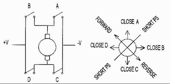

i have 1 x12v battery 1x 12v motor 1x joystick controller and a few IN4004 diodes.What i want to do is when i push the joystick upwards i want the motor to go clockwise when i push the joystick downwards i want the motor to go anticlockwise can this be done with the things i have if not can anyone help me how to do this any help would be great thanks
When the joystick is moved on the diagonal, two switches are closed at the same time, which allows a reversing circuit to be implemented, but there is a catch: When the joystick is moved on the other diagonal, the power supply is shorted, so you have to modify the joystick so that cannot happen.
