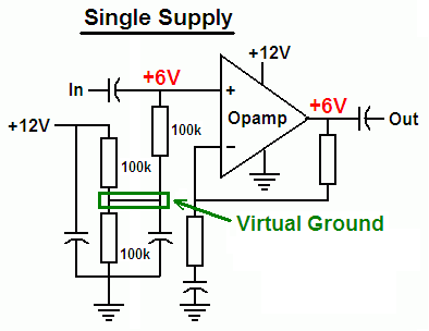

The kid who drew that extremely confusing figure 7 schematic has the battery backwards. He is crazy to ground the positive supply and the output of the opamp. He has grounds all over the place.
Figure 7 is supposed to be a virtual ground circuit that is a very low impedance at half the supply voltage for biasing other opamps.

The diagram shows a OPA being used to create a phantom ground, thats why the output of the OPA is grounded. By using this phantom ground in your system as the common ground reference, it effectively splits the single supply voltage into two, ie +V/2 and -V/2.
So if you had a single supply source of say, 12V, then with reference to the phantom ground [the grounded output of the OPA] you will have a +6V and a -6V for your other OPA's in the system.

Its a STAR ground, ALL the grounds shown are taken to a Common point, which is the phantom ground.

You don't need a virtual ground opamp when you want a Mosfet to drive a load. You also probably don't need any opamp.
Just let the signal (logic level from a PIC?) drive the Mosfet and use a logic level Mosfet.
The circuit with the virtual ground opamp has the load current flowing through the output of the virtual ground opamp and the current is probably way too high for the output of the opamp.

I have made hundreds of battery-powered single supply circuits with opamps and have never used a virtual ground opamp circuit.
Opamps have an extremely high input impedance. Just a voltage divider with a bypass capacitor is needed to bias an opamp at half the supply voltage.
An old LM358 or LM324 can be used without a virtual ground because their inputs work at the negative supply voltage and the output is pulled to the negative supply voltage by the load.
