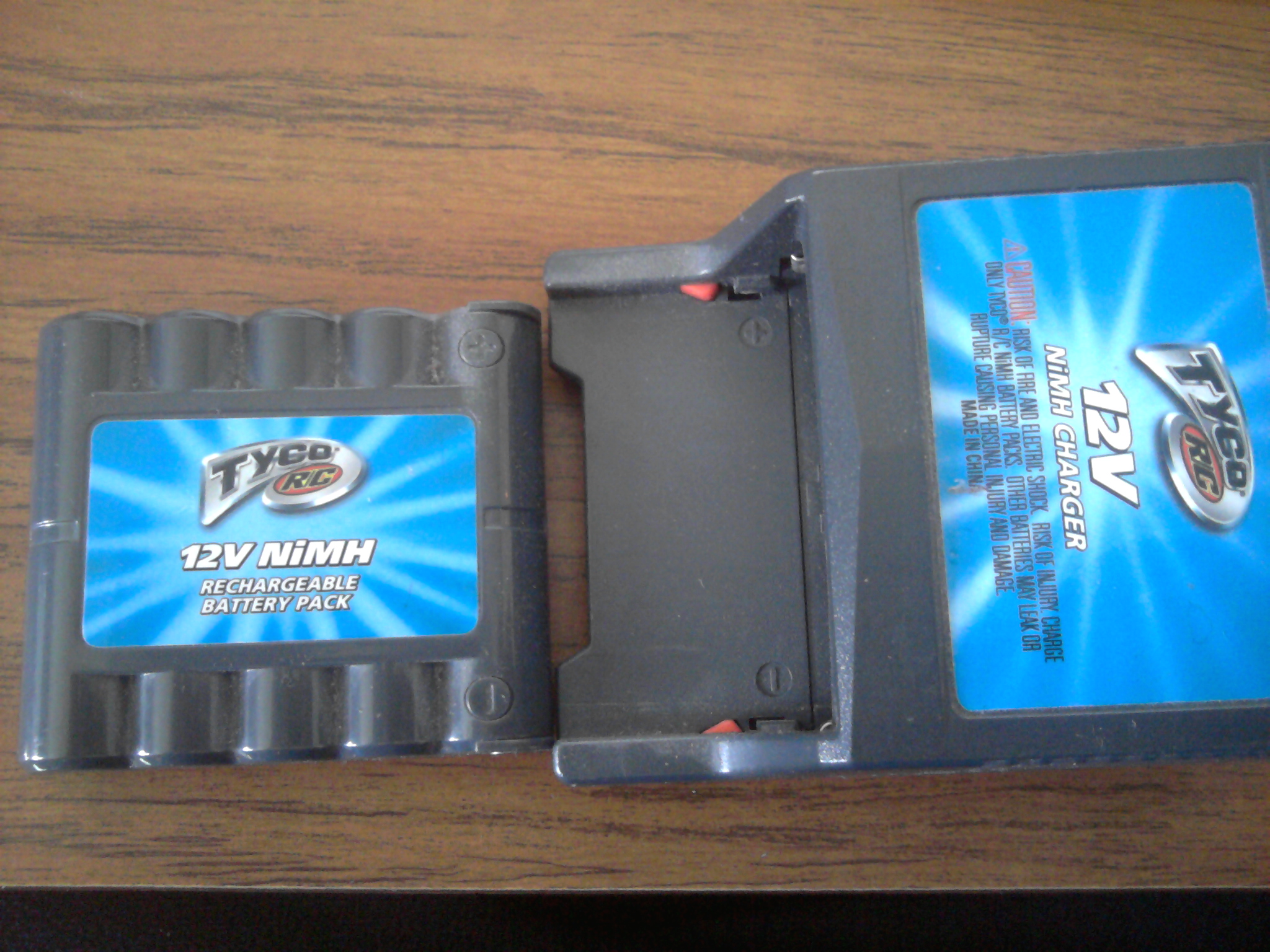

I have a generic 12v NiMH battery from an RC car that I haven't used in awhile. Assuming it still holds a good charge, any idea if it could power the amp for a decent amount of time?
The battery itself has no power ratings of any kind. The charger outputs "14V DC, 220mA, and 3.08VA" but I don't think that really helps.

All bets are off when you talk about a no-name-brand "generic" battery.
Name-brand-batteries are stamped with the truthful mAh.
A Ni-MH battery is charged at 1/10th its mAh rating until it is fully charged, then the charger turns off or goes to a low trickle charge. It can be charged at 1/40th its mAh rating continuously.
Charge the battery then use it to power the amplifier and time its playing duration.
