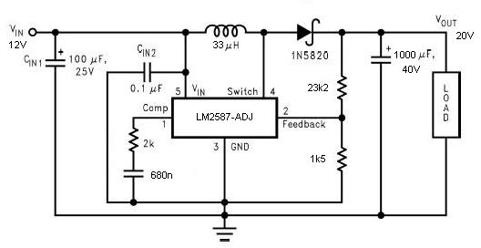

Agent 009 said:The uA741 Op-Amp runs on a 12Vdc, so you could have an amplifier circuit getting your 12 V up to 20 V...
