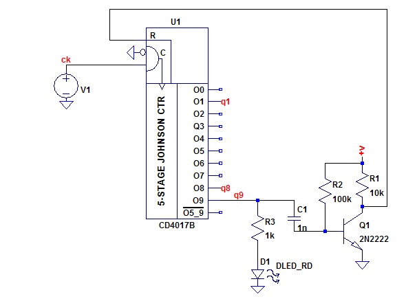

I have a 4017 Decade counter with a clock input pulse form an astable of time period 1 sec. If I connect an output pin (the last one) to the reset (allowing the counter go back to the start) and an LED to that pin also, will the counter reset before the LED can come on for the full second? Or can the LED stay on for the second and then the chip resets? Thanks for your time

As soon as the pin goes high it will Reset back to '0', no 1 sec flash.
You could add a AC coupled transistor to the pin, so that it Resets on the trailing edge of the 1 sec.

Like this.
I don't see why you are bothering to reset it after the last pulse. It does that itself, in that the next count after 9 is 0.
If you want to count up to smaller numbers, you connect the next output, the one that you don't want to come on, to the reset line.
For instance, if you want to have 4 outputs only, they would be 0, 1, 2 and 3. If you connect output 4 to the reset line, then on the next pulse after 3 you will get 4 for only a few microseconds before it resets to 0.

All I wanted to do was to design some sort flashing sign or image for Christmas, and in order to repeat a certain sequence, I needed to reset the chip. Thanks to EricGibbs for clarifying this.
