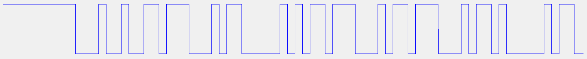

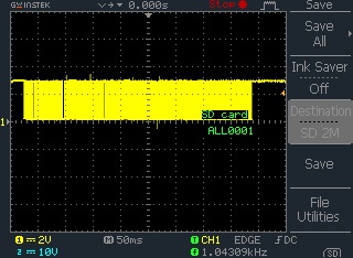

I have an oscilloscope readout of a serial communication (NMEA from a GPS). I need to decode the signal into ASCII characters without running the stream through any hardware. I have attached a snippet of the signal, and how should I initialize the decoding?
The GPS I'm using is a Linx RXM-GPS-SR (https://www.electro-tech-online.com/custompdfs/2013/01/RXM-GPS-SR_Data_Guide-19336.pdf), and the default settings are baud=9600, data=8 bits, stop=1 bit and no parity.
Should the decoding begin from the falling edge and then 1/9600 seconds ahead for the first start bit and then detecting the level of each interval. Or is it the direction of the edge?
According to the datasheet, the first characters should be $GPGGA..., but I can only get the $ using the level of each interval. Can anyone spot the problem? Thanks

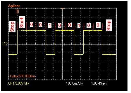

Sorry but your screen dump from the scope is a bit incomprehensible, just a band of bits.
The $ character is 24 in Hex, which gives a binary bit pattern of 0010 0100 with bit 0 at the RHS of the pattern and bit 7 at the LHS.
Whan viewed on a scope, the characters will be written from the left of the screen, so the bit pattern will be 0010 0100 with bit 7 at the RHS of the pattern and bit 0 at the LHS.
Oh dear! it is a symetrical character!
If you are decoding it the wrong way round it will still make sense, but none of the other characters will make sense.
Have a look at the attachment, I have sent a $ character using Hyperterminal on the PC, and recorded it on my scope.
This is an RS232 output, so a "1" is a negative voltage and a "0" is a positive voltage.
The comms set-up is 9600baud, 8 data bits, 1 stop bit, no parity.
The scope was triggered on the rising edge of the start bit.
Does this help?
Ideally you start timing on the first edge of the start bit, then wait a 1.5 baud period (which puts you in the middle of bit0) then detect the level of that bit. Then 7 baud periods, each is the next bit, and finally a stop bit (which should always be high) which shows you your baudrate and timing were probably ok.
Thanks, it was the 1.5 I had forgotten, but still the data is not right. I get the '$' but then an 'â', which should be 'G' or 'P' according to the datasheet
After the stop bit (a high), I look for the next falling edge and proceeds as before (1.5 baud forward etc...)

Yes, like I said earlier, you are reading the characters the wrong way round, ie from MSB to LSB rather than LSB to MSB.
G = 47hex = 01000111 binary
â = E2 hex = 11100010 binary

@JimB: I missed the LSB/MSB point because - I think the symmetric character confused me again.
@MikeMI: No, it is not an exercise, but for the moment I need to decode oscilloscope samples.
It works now. Thanks again.
