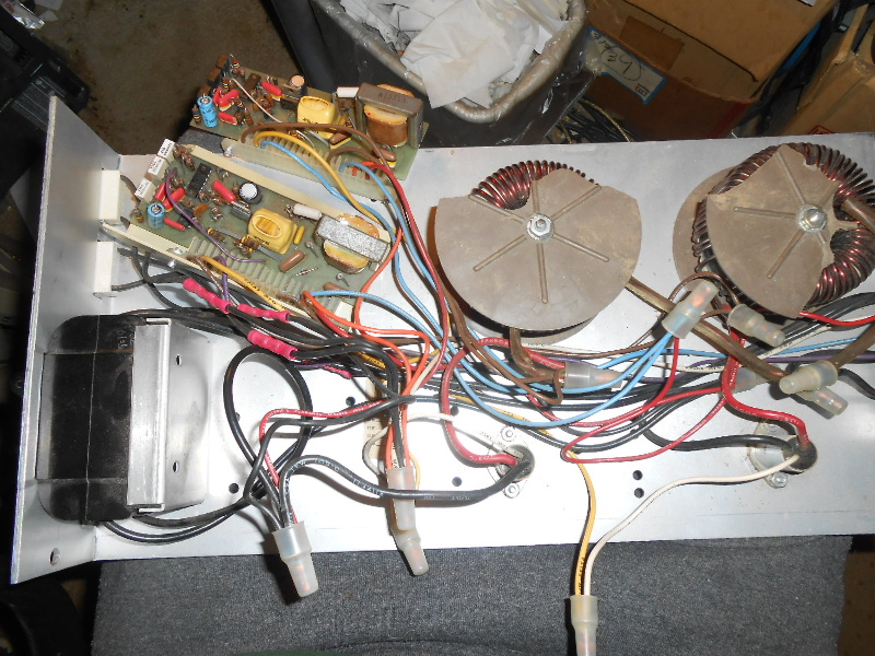

I have 2 Decor Electronics mod 2400 dual light dimmers. i am looking for any info ,,data sheet, wiring diagram,, anything I can find. Hoping I can use these for a project m but have no info on them. Any help please..

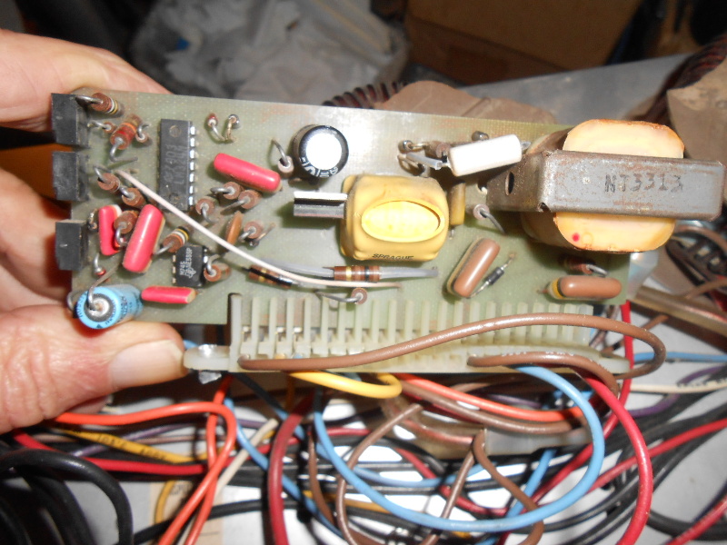

it is a decor electronics dual incandescent light dimmer model num dual 2400 10v. The company is out of biz. input and out put i have figured out,, but control wires and voltage for control is what i am needing... it has 2 control boards other wise simple design. My just be a variable resistor from remote location.

hmmm, this thing is 40 year old. that explains why internet does not find anything about it.
but since it is single sided pcb with only a handful of components, it would be easy to reverse engineer it.
my guess is that 555 is used as saw-tooth oscillator and LM324 is used as bunch of comparators (there are 3 trimmers on the left)

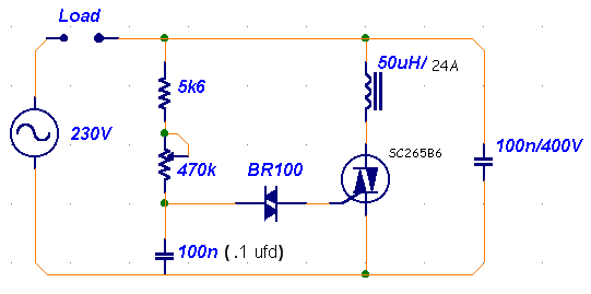

just a thought and a ideal,,,dropping the board and using this circuit and parts from this,, could this work..I have no ideal what the choke is,, but the triac is;
Semitronics Corp.SC265B6
Triac
V(DRM) Max.(V)Rep.Pk.Off Volt.=200
I(T(RMS)) Max.(A)On-State Cur.=40
I(GT) Max. (A)=50m
V(GT) Max.(V)=2.5
I(H) Max.(A) Holding Current=75m
V(T) Max. (V)=1.4
@I(T) (A) (Test Condition)=56
Package=IST-3RT-1/2
The load would be 4500w...am I just in the wrong ball park here or should I just start from scratch?
design is shown in pic
