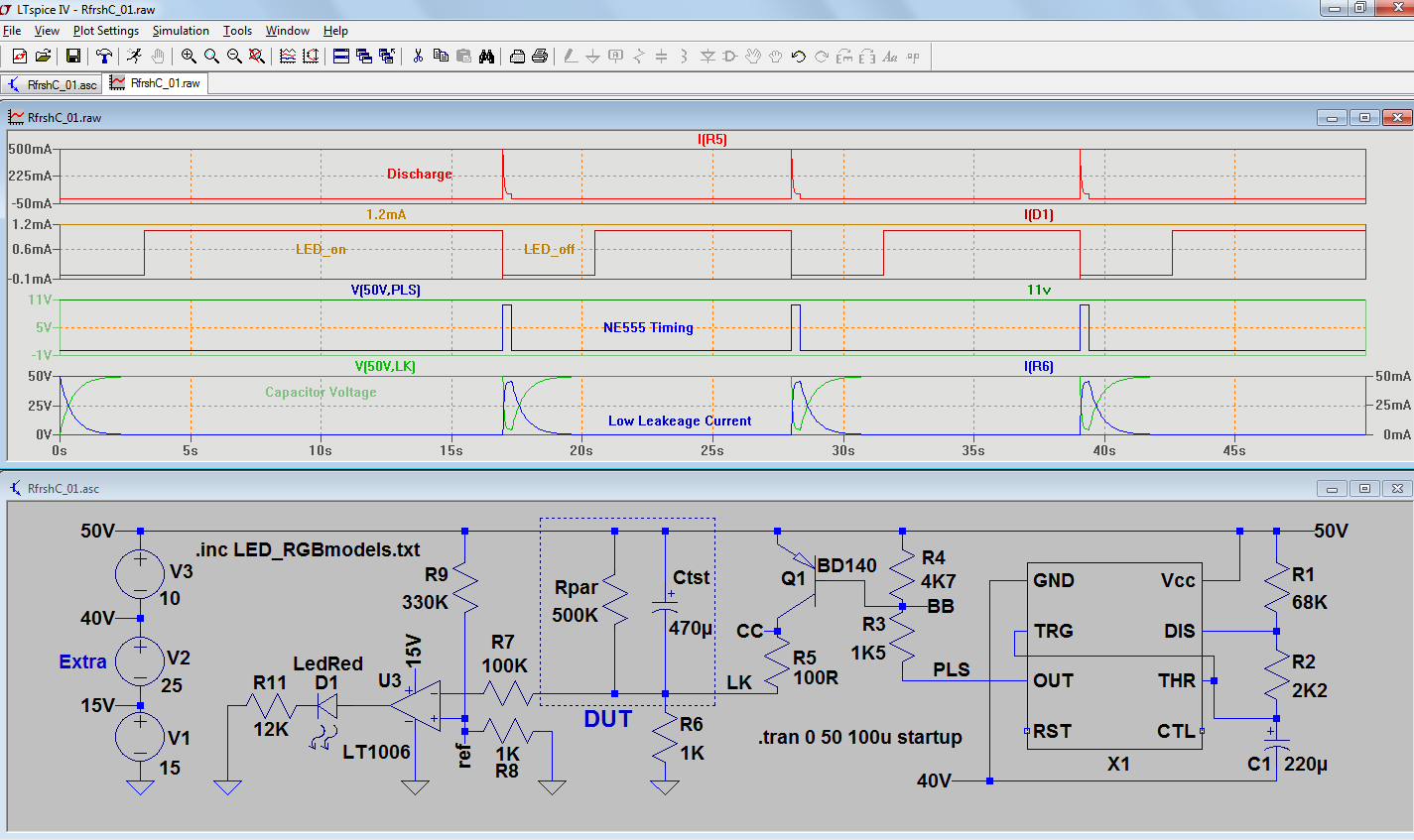

More than two decades ago, I bought many hundreds of 470u/50V capacitor then I forgot about them (the project for which I bought them was dropped). Lately, I needed them, but I found out that their leakage became rather high (low Rpar).
Usually, I refresh such capacitors manually. But since their number is rather big, I built the basic circuit below.
Here, the voltage applied on the capacitor under test (Ctst) is close to 50V. When its leakage current (represented by Rpar) becomes relatively low, the LED turns on, almost continuously. R5 limits the discharging current. The resistance of R9 determines the lowest leakage current that turns on the LED (the higher the resistance, the lower the leakage current to turn on the LED). There are three DC supplies which are connected in series. The first/bottom one (here 15V) supplies the opamp (LM358 or LM324 could be used). The third/top one (here 10V) supplies the timer NE555. The second/mid one (here 25V) is added to let the voltage on the capacitor under test be close to the voltage of interest (here 50V).

I don't quite see the point of the complex circuit?
Charge/discharge is not needed, just time at an appropriate voltage.
All you need is a resistor to feed each cap from a suitable voltage source and leave them for a day or two for the electrolytic layer to reform. You could do them in large batches.
In fact with 50V caps I doubt they could flashover so even the resistors are probably not required, unless you were using them for monitoring?
(Large high voltage ones such as used in massive industrial servo drives need a stepped voltage over a few hours, rather than applying 600 - 700V instantly - but not small low voltage ones).
I didn't hear (or think) of this method yet to refresh old capacitors. But I think it works since you say it.
Unfortunately, on my side, I can't apply it. Since a decade ago, my personal workplace had to be just a small desk (small as the actual apartment in which I had to live :) ). On this desk, I try to test new designs and the new boards (assembled by my assistants), besides repairing or updating a board which could be received at an unexpected time from one of the various products I sold (many thousands).
I assembled the circuit above on a breadboard. So, when I was on the computer desk, I was able placing it on it too and monitor, once a while, the end of refresh which may take 30 to 60 sec (unless the capacitor is defective). I admit it is rather a primitive way but it is also better than refreshing the capacitors manually due to the limited space.
