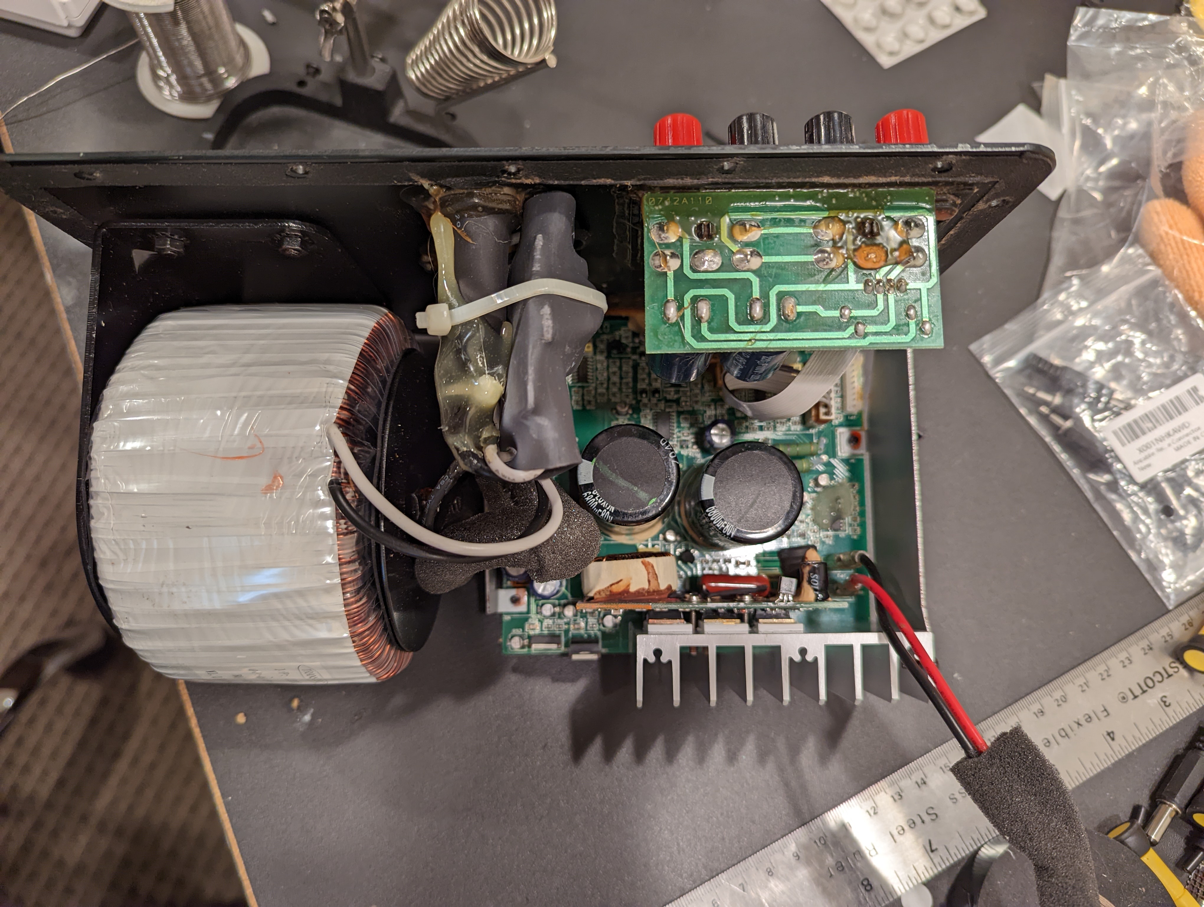

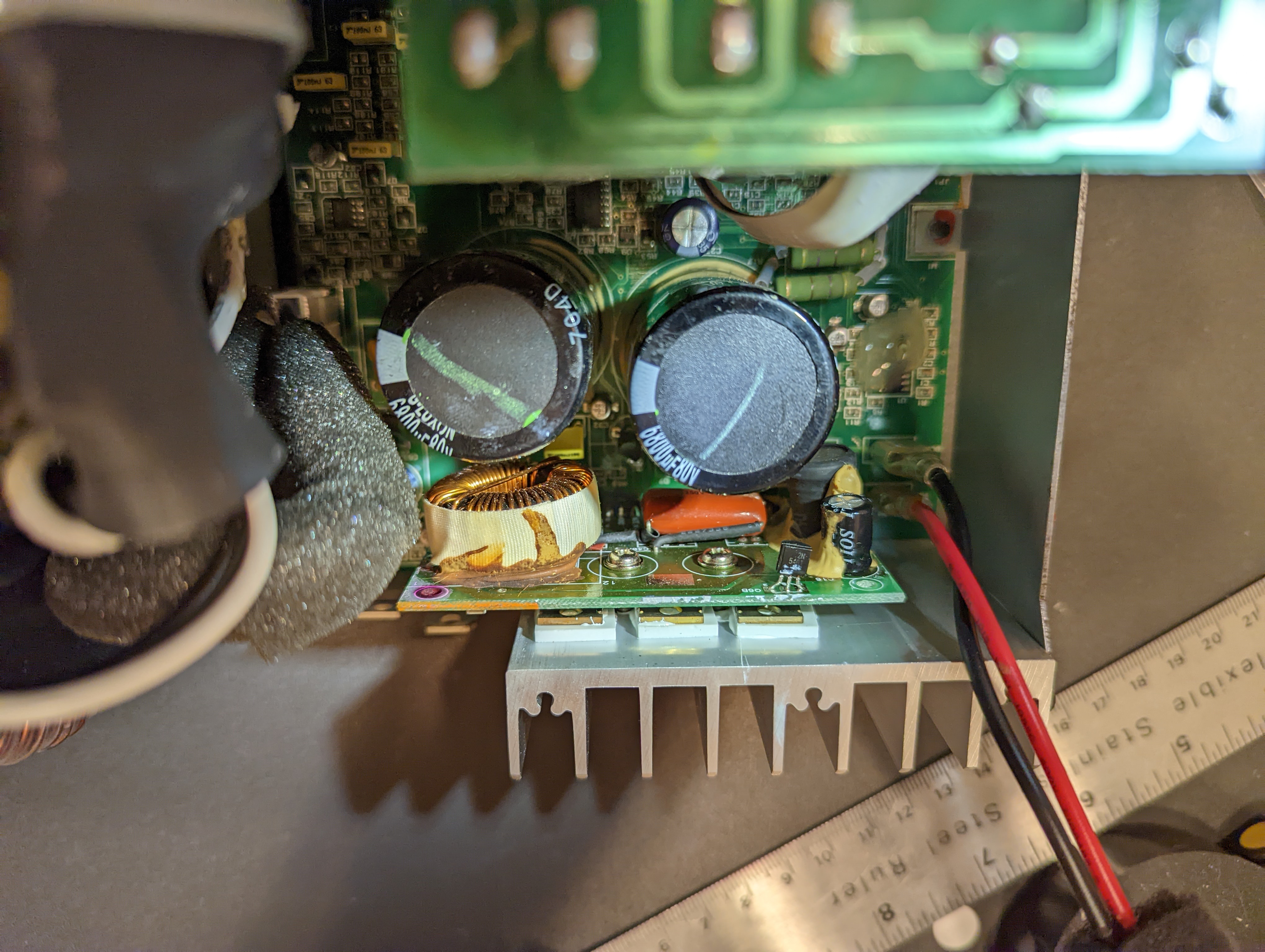

Opened up the sub again to have another look at it. Snapped a couple general pics of the amp. Not seeing any kind of STK chip but there are a couple heatsinked FETs and some large capacitors. I am still waiting to hear back from Definitive about the service book or schematic, they opened a case for me about it. It is going to take more disassembly just to get to where I can even see anything in there.

The same still applies, an STK is just a hybrid thick film circuit, essentially individual components mounted on a ceramic PCB - so there will still be a capacitor feeding the input of the power amp, but without a schematic it's impossible to say which one it might be, without actually having the amplifier in your hands, and not that easy them.

when i worked in a service center repairing these, the schematics were not available from DefTech. the only way to repair a bad amp was to replace the whole back plate assembly. the actual amplifier is the vertical circuit board next to the heat sink, and the output MOSFETS are on the heatsink. it is a class-D amp. the problem you are describing was very common, and it's something getting flaky in the modulator.
Thank you so much for the response. Explains why there are so many of these on eBAY being sold as "damaged, for parts only". I had gotten the boards all disassembled and was figuring that vertical board was the amp (wow they use a lot of glue on everything in there, what a pain). There were two small capacitors and inductor clustered together on the amp board that look questionable but I need to find time to remove those and test them. Although based on what you said the problem may be more systemic than just bad amp board parts.
I never did get a schematic so that now makes sense too, best they did was offer me 20% off a new one, not a great deal really.
that's because it's inside a subwoofer where everything shakes around
