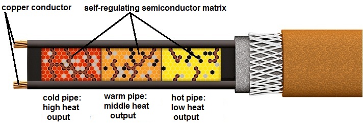

Trace heating cable I've seen can be cut to length.
It's usually got two conventional copper conductors plus either a resistance wire that connects between the two alternately or a high resistance "membrane" element bridging the two conductors.
eg.
https://www.calorique.info/images/selfreg/Selfreg_en.jpg
If your cable has two conductors through it, cutting it will not affect the operating voltage, each section can be used independently.
At worst you get a short "dead zone" at the cut, if it's the wire element type.
If it's only a single conductor then the operating voltage is proportional to the length, for a given output-per-foot.

I was wrong again. The wire does not heat. There is a "PTC (positive temperature coefficient) conductive polymer" that is connected between the conductors. The conductive polymer does not conduct on hot days and draws current on cold says. It tries to keep the cable at some temperature that is above freezing.
It is safe to cut the cable. (insulate the wires on the end) I now see how they get X watts/foot. Cut to any length you want.
