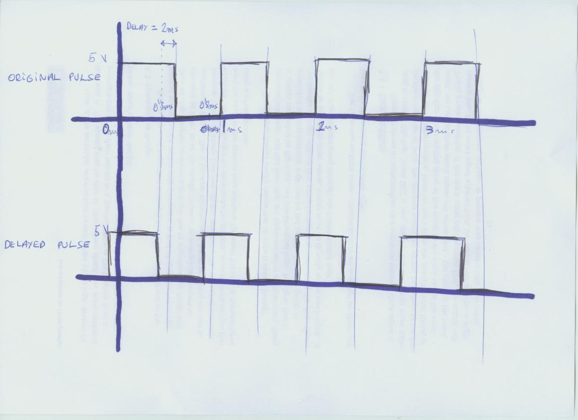

i would like to know how to make a delayer circuit to modify the phase of a squared waveform if possible.
my pulse can be modulated in a [10us-1ms] range. I'm thinking about a circuit done with opamps and capacitors, or an integrated circuit, but i cannot find an integrated with more than 100ns delay.

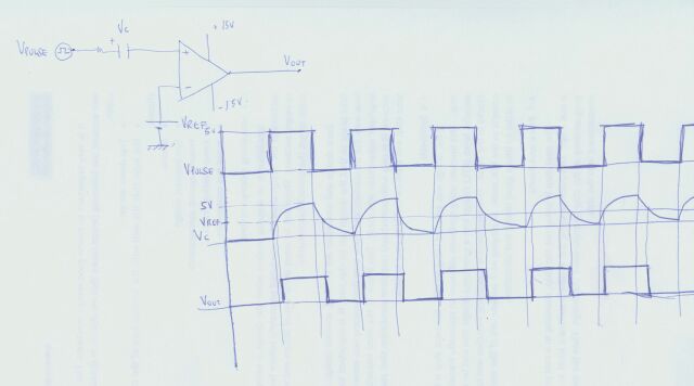

A resistor in series then a capacitor to ground makes a delay. It can be sensed with a comparator or with a Cmos gate or inverter with a Schmitt-trigger input.
i don't know if the circuit you mentioned is this (attached image) but if so, it's not valid because the waveform is changed depending on the Vref value. I need the waveform not to change at all, only the phase has to change. Maybe, i didn't uderstand what you mean. I follow working at it. Do you know another way to do it?

i only need to delay the phase: i have a pulse and i need to have the same pulse but with the phase changed just like in the picture i've posted. Is there any way to do it with an analog circuit or an integrated circuit? (excuse me, all the misunderstandings are because i don't express myself very well in english)
