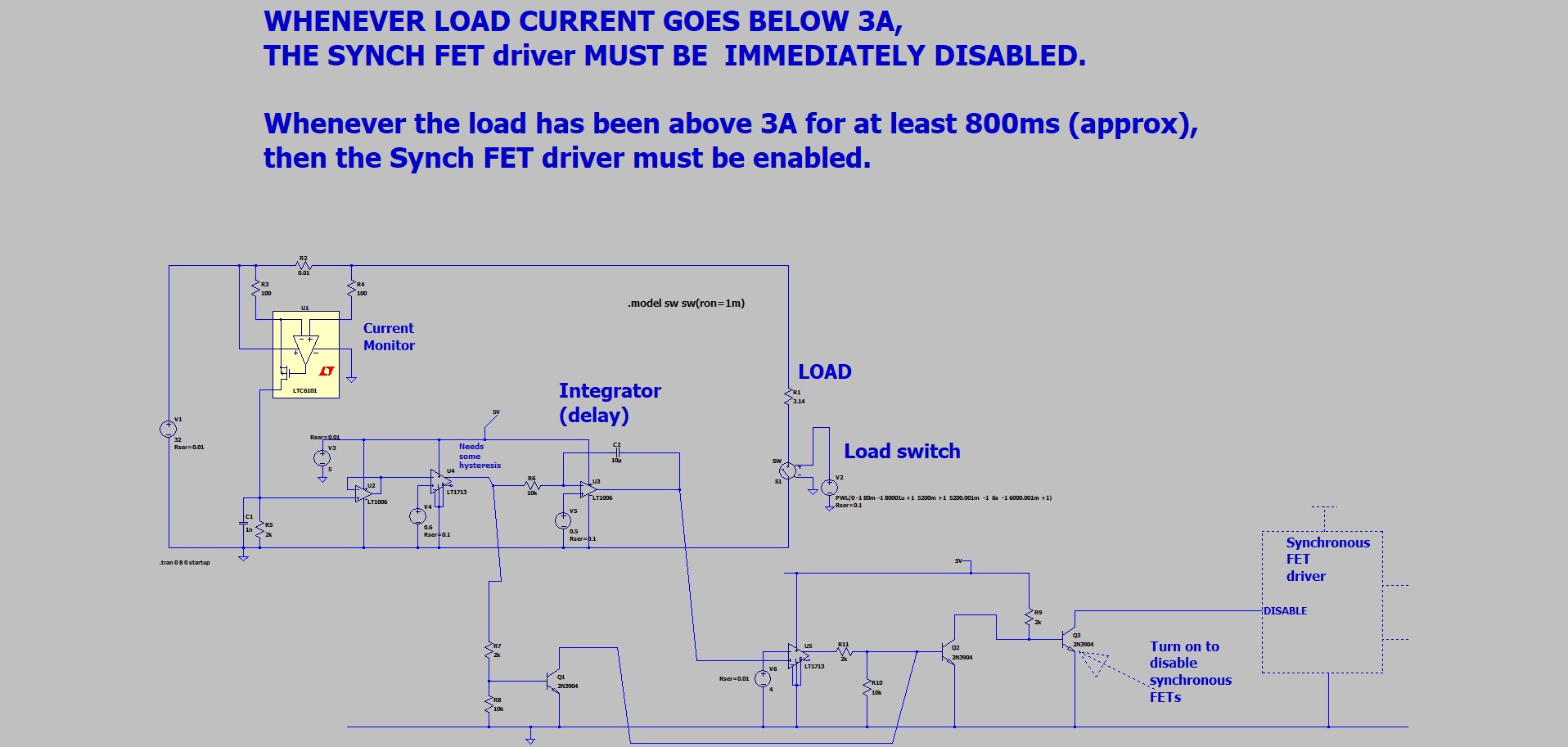

The attached is a circuit which disables a synchronous FET controller whenever the power supply loading goes below ~30%.
This is needed to avoid reversing current in the output inductor, which then causes overvoltages when the synch FET goes OFF.
The circuit also re-enables the controller when loading goes >30%...but does this after a delay of some 1 second or so.
Please can you see any opportunities for reducing component count?
(LTspice and jpeg attached)

Your huge, spread-out schematic with diagonal wires and jogs, is difficult to read.
If you tighten it up and remove the diagonals and jog, I'll take a look.
OK Thankyou for offering to have a look.

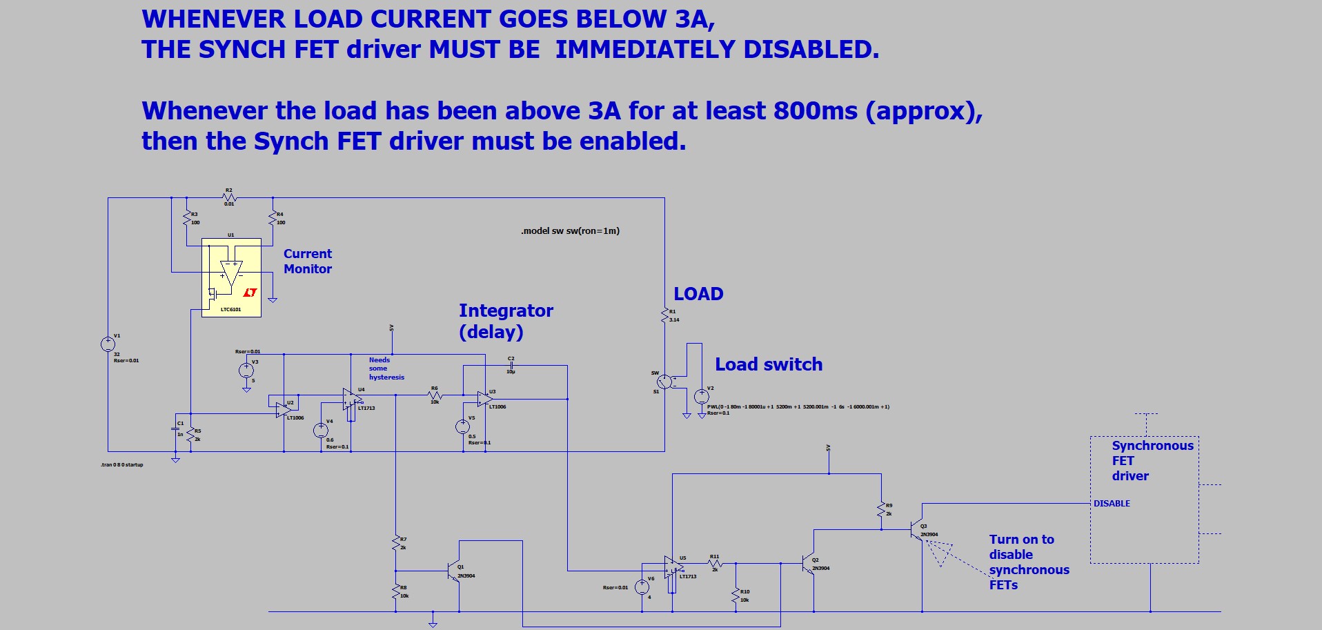

Its straightened up as in the attached if you wish to see it.
But you didn't reduce the size.
It is still way to spread out to see on my screen (for example part designations are unreadable when I look at the whole schematic).
(You must be using a very large screen.)
You need to make the schematic much smaller by moving the parts close together, and reduce the huge font size of all the lettering back to the default, if you want me to be able to read it.

It seems to me that, following the current monitor and Schmitt trigger, a digital delay would be simpler and cheaper than the analog delay if you want to integrate (in chip form) this function.
Yes.....but I have to blow up with ctrl++
That's my point.
If the schematic was laid out in proper fashion with the elements close together and with properly sized fonts, you wouldn't have to blow it up and scroll around the schematic to read the information.
I like neat, compact, professional looking schematics.
If you don't care about that, that's fine with me.
