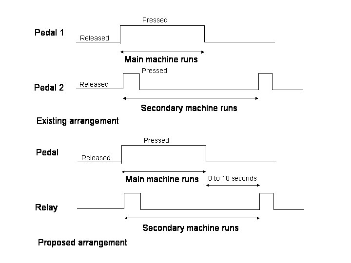

It would help me if you could draw a timing diagram.
Show the voltage across the contacts of each pedal. See attachment for an example,
Following on from my previous post, I have an additional question.
In the first post you wrote:-
"I have two machines that both have footswitch controls (just SP/ST switches, no circuits, both pedals are the same)"
But in a later post you wrote:-
"the second machine is a vacuum exhaust that needs to stay on after the first machine stops, for 1-10 seconds; ..., if it's pedal is unplugged it will turn on; if the main machine's footswitch is unplugged it will not turn on".
These statements appear to be contradictory.
The first indicates that both switches are SPST and are normally open (N/O).
The second implies that the second pedal is normally closed (N/C).
Perhaps they are SPDT and one is wired to the N/O contact and the other to the N/C contact?
I expect that what you need will be a very simple circuit to design, but I need to know exactly how the existing pedals work.

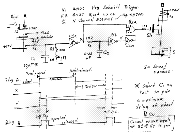

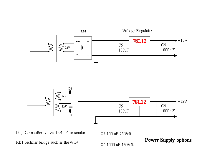

Here is a suggestion. I am assuming that you can derive +24 Volt from the machine.
The +12 Volt can be derived from the +24 V with a resistor and Zener diode.
Circuit Description.
Initial state:- relays A & B are released, capacitor C1 is discharged thus the output of U1a is high so C2 is charged to 12 Volt and the outputs of U1b & U2a are low.
Relay A operates when the Pedal is pressed, it starts the Main machine and charges C1 rapidly to 12 Volt.
The output of U1a goes low and thus the output of U2a goes high which turns Q1 on operating relay B.
Relay B starts the Secondary machine.
C2 starts discharging via R3 so the output of U1b goes low after about 0.5 second and thus B releases.
Relay A releases when the pedal is released. C1 starts discharging via R1 & P1.
When the voltage across C1 decays to the lower threshold level of U1a, the output of U1a goes high which causes the output of U2a to go high thus turning on Q1 and operating B and also C2 starts to charge.
When the voltage across C2 reaches the upper threshold level of U1b, the output of U1b goes low. thus Q1 turns off and B releases.
Setting up the timing.
The 40106 Schmitt Trigger IC has a wide threshold spread, so it is not possible to calculate the precise value needed for C1.
Also, electrolytic capacitors have a +/- 10% tolerance, so a 10 uF cap can be anywhere between 9 uF and 11 uF.
Therefore, you need to experiment with the value of C1 to give the correct timing.
I suggest that you buy three 10 uF, one each of 6.8 uF, 3.3 uF, 2.2 uF and 1 uF.
Then you can (if necessary) connect these caps in parallel, eg. 6.8 uF in parallel with a 2.2 uF will give you NOMINALLY 9.0 uF.
So I suggest that you start with one of the 10 uF caps temporarily connected as C1, set the pot to its maximum resistance and then measure the time from when the pedal is released until relay B operates for the second time.
This time needs to be about 11 sec. so that the minimum time is about 1 sec (ie. when the pot is set to its minimum).
So try each 10 uF in turn, and if none of them give you about 11 sec. then:-
1. if the time is <11 sec. you will have to put one of the other caps in parallel with the 10 uF
2. if the time is >11s remove the 10 uF and replace it with the 6.8 in parallel with say the 2.2.
EDITED to correct errors.

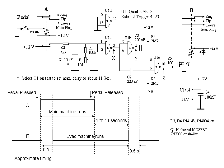

EDIT to include improved diagram and circuit description.
Initial state:- relays A & B are released, capacitor C1 is discharged thus X is high so C2 is discharged.
X high makes Y low thus C3 is charged to 12 V.
Therefore, both inputs of U1c are high so Z is low and thus Q1 is off.
When the Pedal is pressed, relay A operates & starts the Main machine.
The other contact of A charges C1 rapidly to 12 Volt.
X goes low so C2 pulls pin 9 low thus Z goes high which turns Q1 on & this operates relay B.
Note that Z is high if either input of U1c is low.
Relay B starts the Evac machine.
C2 starts charging via R3. When the voltage at U1/9 reaches the upper threshold level (after about 0.5 second) Z goes low so B releases.
When the pedal is released, relay A releases. C1 starts discharging via R1 & P1.
When the voltage across C1 decays to the lower threshold level of U1a, X goes high which causes Y to go low so C3 pulls pin 8 low thus Z goes high which turns on Q1 & this operates B. C3 charges via R4 and C2 discharges via R3.
When the voltage at U1/8 reaches the upper threshold level (after about 0.5 second), Z goes low thus Q1 turns off and B releases.
The circuit is now back to the initial state.
Lazer, I replaced the circuit in the above post to fit in with your latest PM.
This post is mainly to bring it to the top of the queue.
