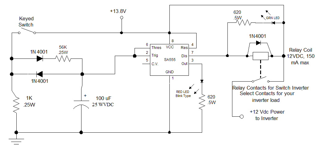

Traveler, see attached schematic. Turn on delay is about 3.5 seconds. Turn off delay is about 0.1 sec. Purchase a blinking LED for the red indicator.
