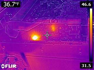

Thanks for the reply. Just out of curiosity, I used the thermal camera on the circuits to see if anything stood out. There are a few warmer areas on the CPU board but one thing that really stood out is ZD501 on the CPU PSU board. I meter tested the zener as good with .7v drop. The diode does not warm up until the master switch is on which turns on the standby systems.
As well, this diode does not heat up at all with the supply disconnected from the CPU board.
Do you think this instant heat level is normal for the diode or would this indicate it is throttling current due to a short and getting hot?
Grr.... I suspect vtech may be right on this one. The thermal image shows the CPU chip. tracing things out and following the heat signatures, R155 on the CPU board diagram is pumping some heat. From the PSU, the 6V goes through only 1 diode, then to the R155 on the CPU board, then another diode. This effectively drops the voltage seen at the chip at 5V and it is further used in multiple circuit at 5V.
Pin 99 on the CPU is the leg going to the M6V from the supply and that leg is also showing a short to ground. I might otherwise wager it is something else but the chip is obviously getting hot and I would think if it were something else shorted, it would show up on the thermal. ??
As well, the zener "ZD501" on the PSU is getting to about 130F! Is that typically a normal situation for a zener holding things back at no load or is this being caused by the shorts in the CPU board? I am having trouble understanding the function of the zener and why it is so hot.

As you can clearly see the heat signatures as being the loading spots. Normally you would continue on and try to isolate the shorts.
Trouble is more than likely you would be going down the path of several components to no end.
And just when you thought it was finally done, there will be more to show up.---believe me been there done that many many times.
I know that folks who spent extra on "higher end" equipment hate to let it go but for whatever reason Denon and lightning simply do not get along.
On a quick look, ZD501 is meant to provide a reference through R502 for a stable standby of +6V at the base of TR501 in the stand by mode.
Idea here is to automatically power down the unit back to standby if/when the incoming voltage drops below a specific level.
Problem arises when +6V line gets zapped (processor is definitely hosed). ZD501 survives the hit however, being the weakest link, it attempts to regulate the standby +6v line which is almost shorted through the processor(may be more)---hence the extra heat.

Question - so with the heat signature of the MCU in the thermal, are we pretty safe to say the MCU is toast? Looking at the data sheet, I think that thing should be at about 100uA in standby.
One thing about the thermal images is you must look at the scale on the side to get an idea of dT. Sometimes the colors make it look worse than it is.
Sounds like you are in the quest to fix it!
As far as current draw goes, yes it should be in the milliamp range. Judging from experience, I can pretty much assure that your processor is gone. Lifting VCC pin(s) usually will bring the standby back---to what level, it is hard to tell. If you happen to luck out, it may be the only load on standby line at the moment and most likely would see a different heat signature.
