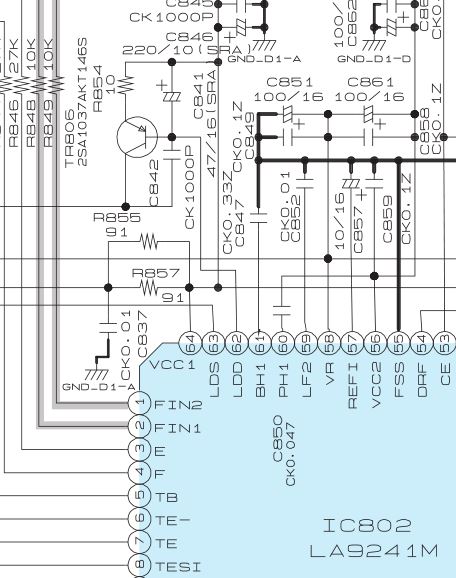

This is my first in depth CD repair and I have the following questions:
I have the above unit, that won't play CD's. I have replaced the laser mech and still have the same fault.
The CD will 'twitch' but not run up to speed.
Using service mode I am monitoring the output from pin 62 IC802 and it never seems to go low (thus powering the laser).
Clock, data, CS and all Vcc lines are correct and the chip is being told to turn on from the processor.
I have also checked the operation of TR806.
Has anyone had experience of these IC's failing or is there another possible cause?
Please let me know if I have missed anything!
