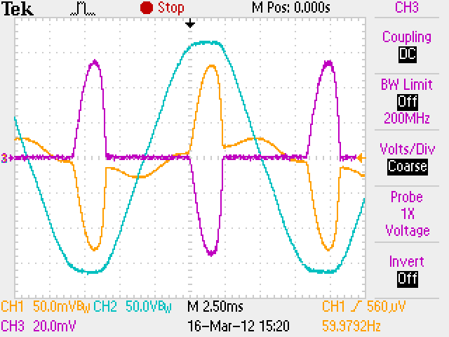

Beginning power supply builders soon discover that a given transformer can't supply as many DC amps when used in a power supply as the transformer is rated for by the manufacturer. This is because the transformer rating is for an AC resistive load which draws a current whose waveshape is a sine wave, like the waveform of the grid voltage. When the transformer is used in a power supply with a capacitor filter, the current drawn from the secondary is no longer a sine wave; it's a narrow, peaked waveform, and such a waveform causes extra heating in the transformer. This is why the transformer must be derated when used in a rectifier/capacitor power supply, and that's what this post is all about.
I've attached an image showing a scope capture of the voltage and currents in a rectifier/capacitor power supply project. The blue trace shows the grid voltage, slightly flattened on the peaks. The orange trace shows the primary current and the purple trace shows the secondary current. You can see that the currents are very non-sinusoidal. To correctly measure their heating effect you need a true RMS responding meter. You can see some extra waviness in the primary current compared to the secondary current; this is the exciting current that supplies the magnetic core.

The key to derating the transformer for rectifier use is to simply see to it that the heating in the transformer is no more than the manufacturer specifies. What this means is that if we're not using the center tap, we must see to it that the current in the secondary is not more than 3.00 amps RMS. It's that RMS requirement that comes into play when a transformer is used with a rectifier. The current in the secondary is no longer a sine wave (see the attached image), but is a narrow, peaked wave shape. The heating effect of this current is determined by its RMS value, and this is why we need a meter that can measure true RMS.
I connected a bridge rectifier to the secondary followed by about 10,000 uF of filter capacitance. I connected a power rheostat to the DC output of the filter capacitor so that I could smoothly adjust the load current. I set my DMM to measure AC current and connected it in series with the secondary winding of the transformer. Then I adjusted the rheostat until I measured 3.0 amps RMS AC current in the secondary winding. Next, I set the DMM to measure DC amps and moved it (reconnecting the break in the secondary circuit where the DMM had been connected in series) to be in series with the rheostat without changing the rheostat. This gave me a measurement of the DC load current which would cause an RMS AC current of 3.0 amps in the secondary. The result was a DC load current of 1.84 amps.
So we see that the transformer has 3.0 amps RMS in the secondary winding, leading to the maximum allowable heating according to the manufacturer's rating, but we're only getting 1.84 amps of DC from the rectifier/capacitor. If we calculate the ratio 3.0/1.84 = 1.63, there's our derating factor. If you want 1.84 amps of DC, you need a transformer whose AC rating is 3.0 amps. If you want 5.0 amps of DC, you need a transformer whose AC rating is 1.63 * 5.0 = 8.15 amps.
A derating factor of 1.6 is often specified in various places, and that's a good start; now we see where it comes from. It depends on many factors, but as I've shown, it's easy to actually measure given a real power supply. Just vary the load on the DC output and measure the RMS current in the transformer secondary. When the DC load is such that the secondary current is just equal to the transformer's AC current rating, that's how much DC current you can safely get.
