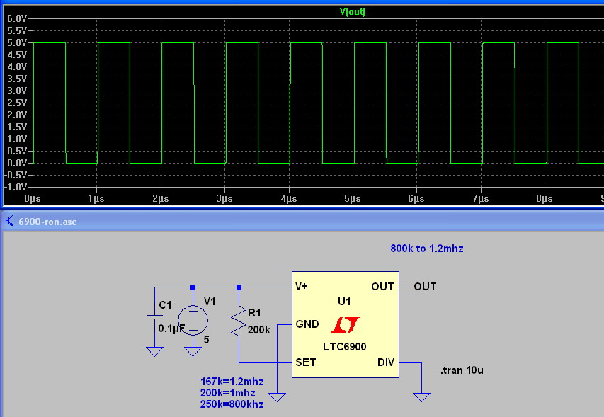

I am going to design a function generator but i am in trouble at first step that is rectangular wave.
I tried to make it by op amp in astable mode but it must be work at 1MHZ and op amp is not a good way to design.
guys please help me to pass through my first step
that is to say that this generator must provide 1.5A in out put and the amplitude is 20V (peak-peak)
