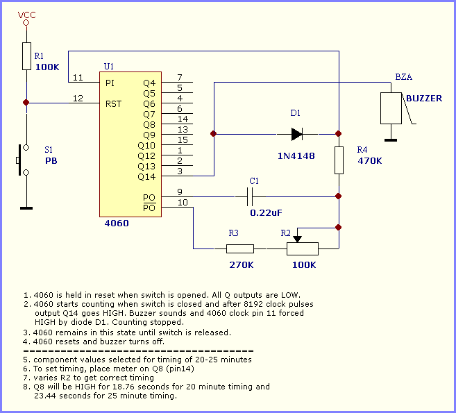

For the original poster, here is the circuit.
You can combine the resistors R2 and R3 and use just one fixed value resistor if the timing inaccuracy can be tolerated.
The idea is to choose the buzzer operating voltage to match the battery voltage. The circuit works from +3V upto +9V with no change in component values. To save battery consumption furthur, you can even replace the 100K reset pull up resistor using 1M resistor without series problem.

Hi L. Chung,
I like your simple and very elegant solution! :lol:
That looks great! Len, I had no idea that a 14-stage counter /w Oscillator CMOS IC existed, and L.Chung, the diagram you posted seemingly could not be better suited for what I had in mind. Thanks!
Regarding the circuit posted, I am not sure about the following:
1) Is the purpose of the diode solely to prevent "clock" pulses from reaching the output pin, or is there something else to it?
2) One Spec. sheet for the 74HC4060 suggested using a tiny capacitor to connect Pin 11 and GND (stray capacitance) for RC oscillators - I was planning to use them, but is there any reason why I shouldn't?
1. the diode stops the oscillator when output Q14 goes high. Otherwise, the counter would continue counting and eventually Q14 would go low which may not be what you want. You said you wanted the output to stay high until you reset it manually.
2. There are 2 issues with the 74HC4060. Firstly, it can only operate on 5 Volt and secondly, it is faster than the 4060 and therefore you may have unwanted complications. I recommend the 4060 or the 4541 programmable counter.
Also, be sure to connect a 100nF ceramic capacitor between the Vss and Vss pins to reduce the supply impedance.
Note that you could use a 32.768 kHz crystal instead of the capacitor and resistor if you want more accuracy. But you would need another counter.
Len

This is what I want, and I understand why Q14 is connected to PI. However, it looks as if a simple piece of wire will also be able to connect Q14 to PI. My question is: why use a Diode as opposed to a simple connection? My initial guess for the diode's inclusion is to prevent clock pulses from reaching the output pin, but I may be wrong.
To L.Chung; I do not expect the PB to be lifted immediately after the buzzer sounds; still, what difference will the diode make?
The un-operate Q14 level is low, i.e. 0V. If you connect PI directly to Q14 using a wire, then the clock of 4060 would be permanently LOW which also stops 4060 from counting up.
So you are partly correct that the diode prevent clock being affect by Q14 when Q14 is LOW.
Without the diode, the buzzer still will not stop immediately, it will sound for the same duration, i.e. 20 minutes, before it turns off again.
I do not know how I missed that function of the diode. I believe this particular emoticon is appropriate: :oops:. That clears things up for me.

You could leave the diode out (ie. no connection between Q14 and PI) since Q14 will be low for 20 minutes. I assume you would reset before the 20 minutes expires.
