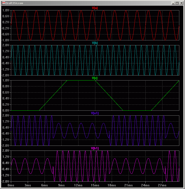

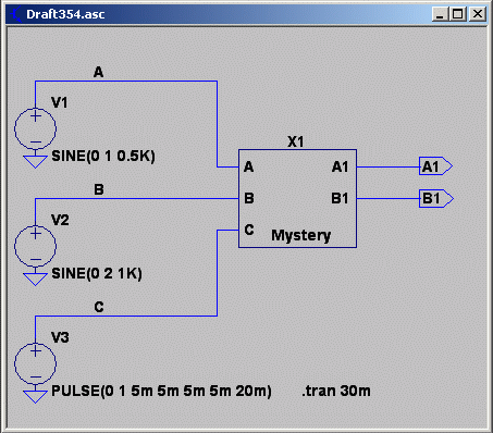

Is this what you want to do?

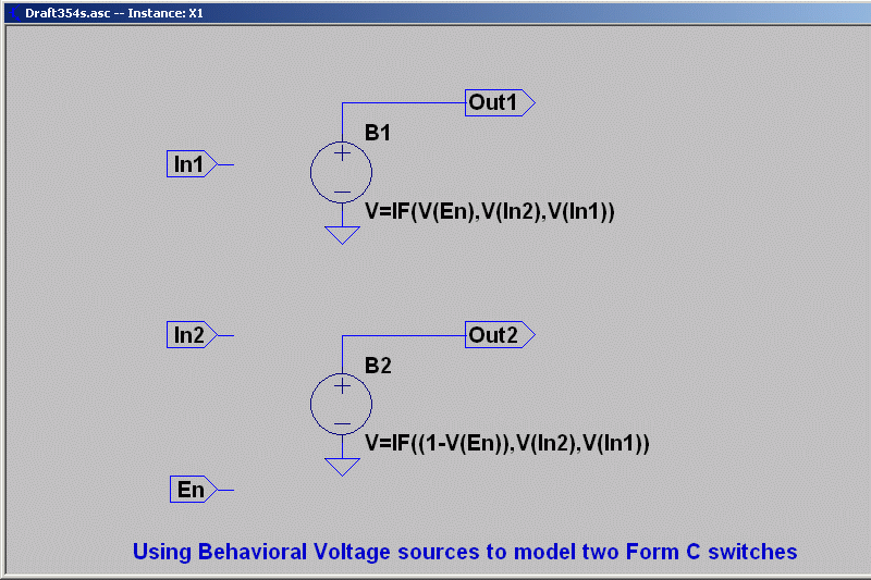

If V(c)<0.5V, then V(A1) = V(A) else V(A1) = V(B)
Oh, I suppose you want to know what is in the mystery box?
Hint, it doesn't use any of LTSpice's Switch components. It uses BVs....
The TS wasn't curious enough to ask to see what was in the "mystery box", so here it is in case somebody else looks at this thread...
