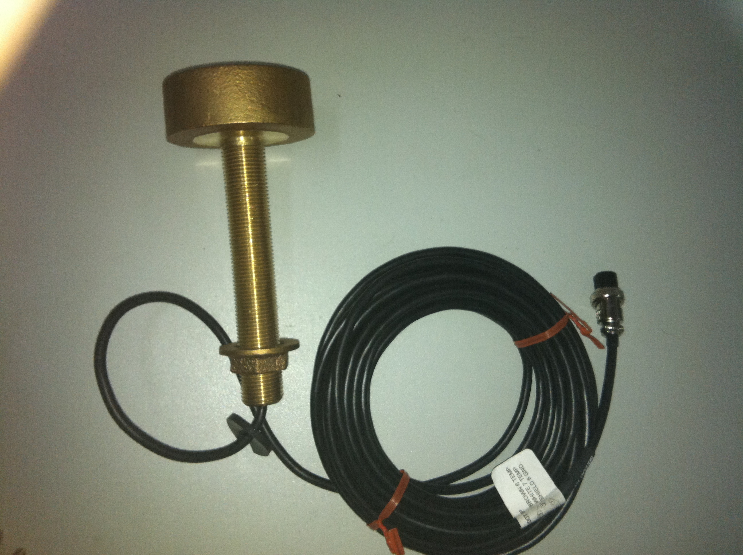

yes, i have already transducer. 95% accuracy and above. 60m to 150m
What frequency is the transducer.?
For 150mtrs, you will require about 80/100Watts at 5 pulse/sec
frequency is the transducer is 50kHz
i see power of transducer is 600W
