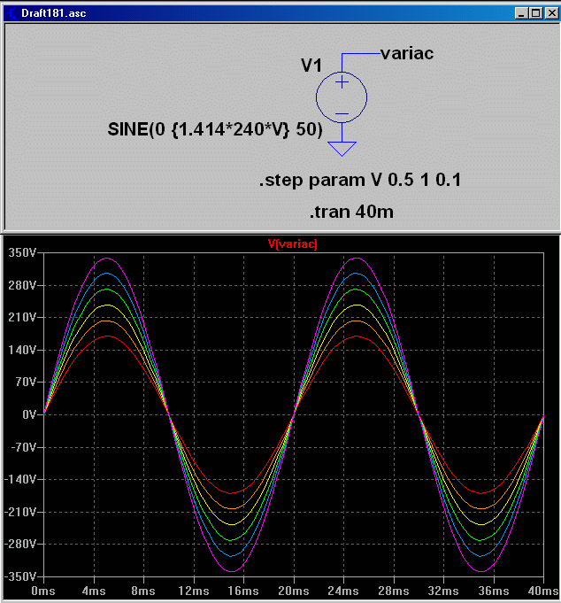

I frequently use the variable AC voltage source on my real lab. desk.
Does it exists in ISIS (like variable potentiometer)?
It will be very useful because of changing the power supply voltage
in simulations!
Thank you for attention!

i think no
becoz i want use that as power source , any project i feed that output in transformer
not signal sensing
That is why I use LTSpice: a voltage source is a voltage source is a voltage source. No phony little "instruments" (signal generators, scopes, dvm, etc) to get in the way of what you really want to do...
Example. Parameterized AC source simulates a 240Vrms Variac. It is set to 5 different voltages; 50% of 240Vrms to 100% of 240Vrms in steps of 10%.
