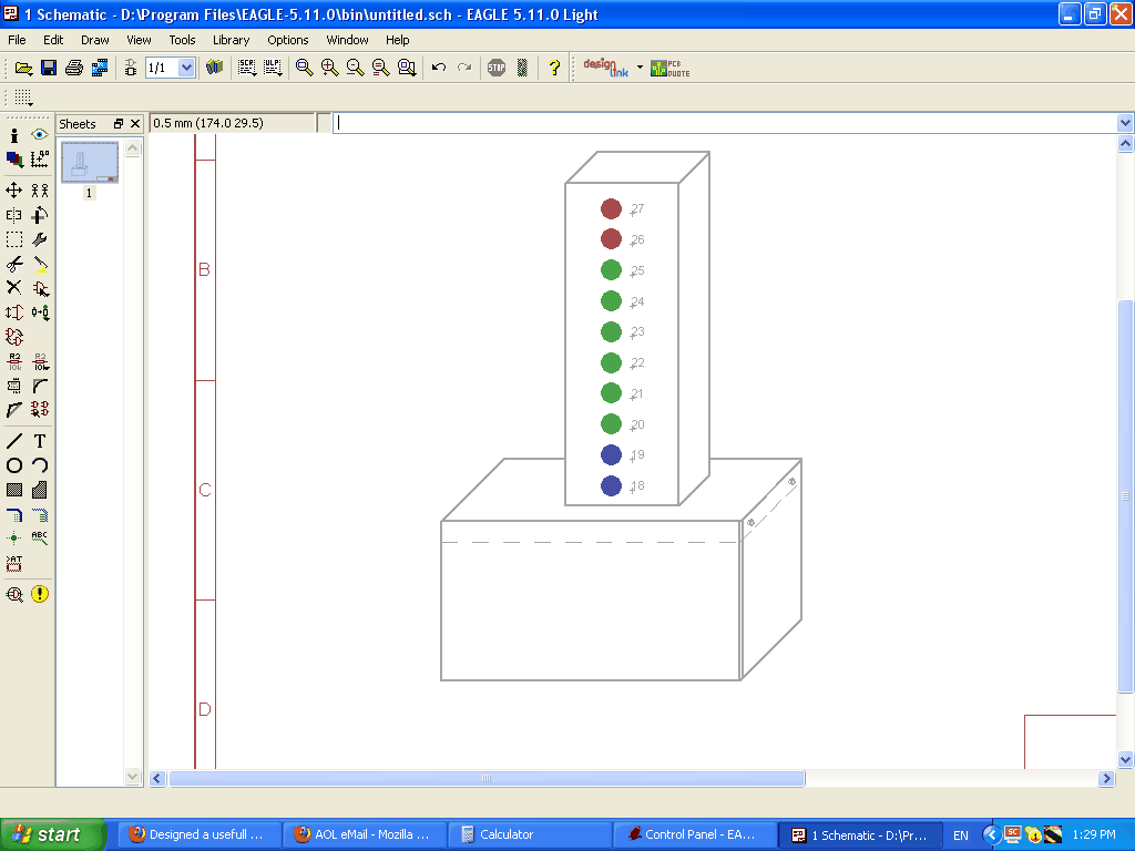

Hi tvtech,
you might also make a "tailored" enclosure from scratch (more or less :)
Here are two ways I used to make a room temperature indicator for my parents:
The main circuit (including power supply) was housed in double sided FR-4 material. Bottom and side panels were soldered together inside for a stable box.
The 10 LED column was housed in a top box made of acrylic glass with the bottom having 6mm thickness (for threaded holes)
I didn't have any special tools to cut panels to shape and just used a fretsaw and a file for accurate and snug fit of the two parts. (upper and lower box).
To mount the two bodies drill 3mm dia holes through the FR-4 material and drill threaded M2.5 holes into the bottom acrylic glass. Using lentil head screws they will be flush with the copper surface.
If you want to give the copper a good finish use some strands of a brass brush which you glue into a round piece of wood and use a drill press to gently scratch an overlapping circular pattern on the copper with the brush rotating at max. speed.
(That pattern might be seen on box cars used to transport frozen food.)
To prevent the copper from turning green after some time you might use one or two coats of clear boat laquer.
Regards
Boncuk
