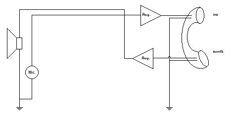

All i want to design a simple Door Intercom .
1) One End which can be placed at Door Side ( handset free ) , which the visitor can use , the visitor will press a button present on the door plate which will cause a ring to occur on the inside intercom.
2) Inside the house there is intercom with handset.
3) The above system should work on 2 wires.
I have designing a 4 wires intercom system using 18 Volts supply when the visitor press the bell at door side,
at door plate LM386 is used , and for Bell KA2410 is used...
iam unable to understand how to design a full duplex door intercom using two wires....
it has something to do with transistor switching or hybird theory i guess which is used in telephone set for converting 4 wires coming from speaker and MIc into two wires,,,
the objective is to transmit current and voice signal on 2 wires only....
let suppose that the above door intercom which i made using 4 wires is need to be converted into 2 wires on which voice and current should go at the same time what intermedaite circuit i have to use....
just think that there is a system on 4 wires and we have to place an mux or decorder or any transistor switching which can converted it into 2 wires system...

Hi waqar,
To achieve the sort of thing that you get with
'conferencing' on a telephone, where you can switch
to 'speaker' and talk to the telephone like its
another person,
is actually quite difficult to achieve on a
do-it-yourself basis, there might be ready made
units you could buy.
however here is a simple arrangement that relies
on you keeping the gain low enough not to oscillate.
It is clear that the external mic will be able to
'hear' the ext speaker, but so long as the gain to
the earpiece is kept very low, it wont get back
via the mouthpiece to cause oscillation.
i havent drawn the press button wiring, i hope you
are ok with that.
It is not truly two wires, as it uses earth also,
but circuits for neutralising with only two wires
are not easy to set up.
Hope this helps.
John
