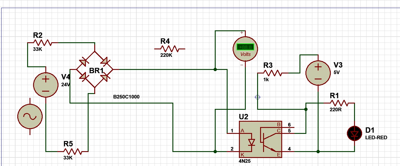

Hi thanks for your idea. what I am not clear about is where the 220k resistor is placed
After R2 & R5, across the AC input to the bridge rectifier.
It's to discharge or bypass any capacitive pickup; the optoisolator may switch with less than 50uA through the LED.
Note that you will have to modify the 4N25 parameters for it to work in simulation - the TLP627 has a CTR of 1000, while the 4N25 is rated around 50 - 80? if I remember correctly.
Edit - And R3 MUST be 10K for it to work over the range I worked out.

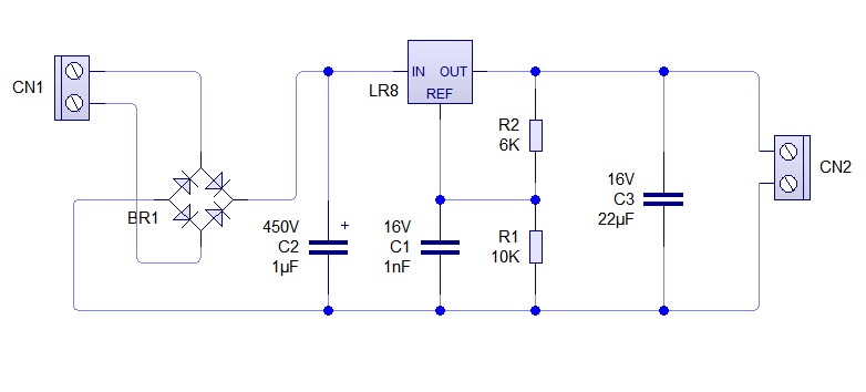

I am going to opt for the microchip circuit. It is a small chip and it is not expensive and the external components do not take up much.
For those who can serve you these are the values of R1:
10k - 3.3V
18K - 5V
52k - 12V
CN1- 10 ... 400V AC / DC
CN2 - DC OUT
* Schematic and values of microchip reference components.
That does not provide isolation - it will pass high voltages to the output.
If you do not need isolation, you can use eg. 1M resistors direct from the test inputs to a couple of MCU pins...

Hello friends, in case someone is of use to you, after the tests with the LR8 the conclusion is that it goes perfect, from 9VDC / VAC to 260VDC / VAC.
I have configured the LR8 so that it takes 3V and I have put an opto to the FOD852300 output that has a ctr of 1000% with a resistance in the 1k led, the consumption is 0.002 mA/ Iinput 240VCA. and the temperature of the LR8 less than 15 degrees centigrade .
The truth is that microchip does not disappoint, it makes good products.
