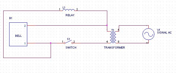

I want to detect when someone press the button of bell's door.
Maybe with a AC relay it's possible to do it? What is the best to detect it ? The transformer has 120V on side and on the other it's 18 VAC...
I uploaded what the circuit of the bell's door like...
Your circuit will work for as long as the button is pressed, as soon as the button is released the relay will drop out.. Is that what you want ?

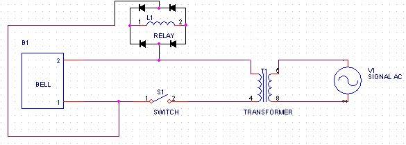

When the AC relay not available...
Yes, the contact of relay will activate a input of a microcontroller...

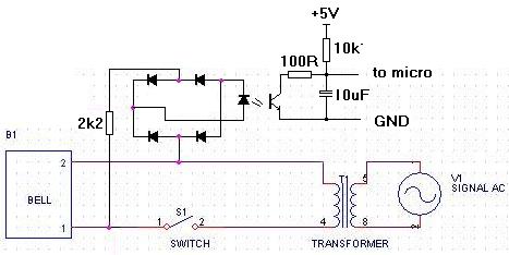

For microcontroller interfacing more elegant an optocoupler...
