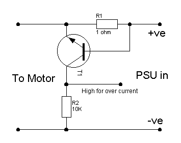

It depends what current you are trying to sense, and how much voltage you can afford to drop during normal use. This simple design will provide a high level output if the current exceeds about 700mA - you can increase it by decreasing the value of the 1 ohm resistor.

However, when the over current pin is not sent high, does it leak any amount of voltage? I'm wondering this because perhaps it might constantly send the AVR's input high.

No, it shouldn't leak any current under normal use, however as there's no form of hysteresis (not quite sure about the spelling!) it won't give a sharp switch, but will gradually rise as current increases around it's switching point. By careful selection of the resistor value, and how the software reads it you should easily be able to get an extremely effective design.
Bear in mind that as the motor turns, and also from a cold start, it might briefly trigger the overcurrent sensor - your software should take account of this - simply by requiring the sensor line to be high for a specific amount of time. So if you sample the line every 50mS, you should wait for something like 10 sucessive over current readings before concluding it's reached the end.
You can obviously tailor these figures as you require, but presumably you get the idea?.
Obviously for testing purposes, you could simply use a voltmeter on the sensor line and see how it works - adjusting the value of the 1 ohm accordingly. As you can see, it's very simple and cheap, so you can afford to experiment a little!.

As long as you switch the motor after the current detection circuit it won't make any difference, it will work just the same in both directions.
It would also probably be a good idea to put a resistor in series with the base of the transistor - to limit base emitter current in the event of a short circuit on the output.
How would it still work if the NPN transistor will be getting a different polarity? That's what I'm wondering.

It won't be getting a different polarity, that's why you switch the motor after the circuit and not before it. Obviously if you switched the supply going in to the circuit it wouldn't work, but there's no reason to want to do that.

You can use pretty well any opamp to monitor the current drop across a resistor, but it's probably going to be more complicated than this simple circuit. The biggest problem is likely to be the supply for the opamp, you may need to provide a higher supply just for the opamp (and perhaps a negative supply as well). However, using a rail to rail opamp may overcome these problems.
The advantage of using an opamp is you can have a much smaller voltage drop across the resistor - with my simple design it needs 0.7V, which gives about 0.5W with the 1 ohm I used, correspondingly higher with lower resistors and higher currents.
But it's so simple, throw it together and try it with a meter!.
