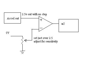

Is it possible to detect steps on the floor? I mean the tremor from the feet.
Hard grounds should transmit steps, of course for a very small area.
Is there a sensor avaliable which could detect it an gives a "wake up" signal to a microcontroller?
Any suggestions
Greetings Charon102
you could use an Accelerometer with an op-amp to triger the microchip

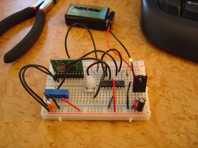

you're probably right
i put this together with 2 op-amps
it flashes a led when you walk, but not if you walk slow
and it is hard to tune.
