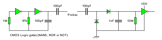

I made a simple circuit consisting of 1 BJT to pass a small current through water and the base of a BJT and a resistor so that enough current flows in the collector to light a led.
well it worked but bubbles are comming from the negative "probe" and I'm sure that the water around the positive probe is going ever so slightly white.
Am I just putting electrons into the water or am i actually disolving my probes ?
Perhaps some sort of methos using alternating current is required ? so that the prodes do not irreversably disolve ?
Look up electrolysis on Wikipedia.
If you don't want it to happen, you should use AC and couple the probes via capacitors.
The circuit can be made using a few logic gates.
ok well that starts to explain a few things, we have these pumps at work with sensing circuitry inside them, but they kind of keep going when the water has run out so I started some tests at home to see if there is a simple way of doing it. Also because he is using "AC" and there are two pumps per unit and I think the circuits are over sensitive and one picks up the signal from the other so both run when one starts.
so if I decouple the sensors with caps and say I'm running with 24 V, that means that i will have +/- 12 V and need to rectify the signal again which can be done with one diode. so maybe used the same setup with a transisor but supply it with pulses instead ?
I'll knock out a schematic and post it
I'd recommend using a CMOS logic IC.
As you're using 24VDC, you'll need to add a MOSFET and a regulator.

This circuit will work, without disolving the contacts.
I've just realised, the circuit will be easier to make and better with Schmitt triggers.
Replace the first two gates with a single Schmitt trigger oscillator and the second gate with a Schmitt trigger.
With the circuit as it is, there's a risk of the output being biased in to the linear region which won't happen if a Schmitt trigger is used because it has hysteresis.
If you don't have a Schmitt trigger logic IC handy, you can use the hex inverter: a Schmitt trigger can be made with a couple of inverters and two resistors and added to the output
If you only have quad NAND or NOR gates, it's possible to make a Schmitt trigger with an additional gate and transistor; the latter can double as the load switch.
I'll post a schematic, if you don't understand.
well this is currently hypothetical I am trying to understand something of how the units we have at work function. so what difference exactly do the schmitt trigger gates make ?
If the resistance between the probes is too high to turn the output fully off but too low to keep the output on the output will sit somewhere inbetween 0V and VDD.
In other words, if the voltage across the 1nF capacitor is in between the logic levels of the gate the output will also be neither high nor low. In the case of the CD4000 series, this will happen when the gate voltage is exactly half the power supply voltage.
I Schmitt trigger has different turn on and turn off voltages so this will never happen. For example it might turn on when the input voltage is above 2/3 of the supply voltage but it won't turn off until it drops below 1/3 of the supply voltage.
Using a Schmitt trigger also means the circuit can be built with only two gates, not that this matters as there'll be some redundant gates. As I said before, if you don't have a Schmitt trigger IC, you can easily improvise.

your right of course, I am not actually planning on building the circuit, I am more intereted in second guessing how a product we use at work works, these are small pumps that are in air conditioning evaporator units and are used to pump out condensation, so it should be pure water but I have seen sand it on units and have no idea how it got there unless picked up from the air.
I don't think there is a high and low sense, I think the designer has used 1 probe as common, one to inject the signal into the water and the other to pick it up again, small wonder that when one pump goes into action so does the other as it is so sensitive that it just picks up the signal from the other one
What's the dielectric constant of pure water?
If AC is used and the dielectric constant is high enough, pure water will increase the capacitance between the probes which might reduce the impedance enough for the circuit to trigger.
