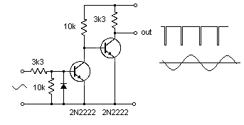

A possible solution...

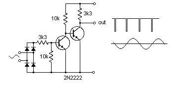

Is the output correct? During the -ve part of the input cycle the first transistor will be off, forcing the 2nd on and the output low not high? Output will be a square wave unless the input is taken from a full wave rectifier that have only +ve cycles
Absolutely right, the quick draw not always good...
Correction
