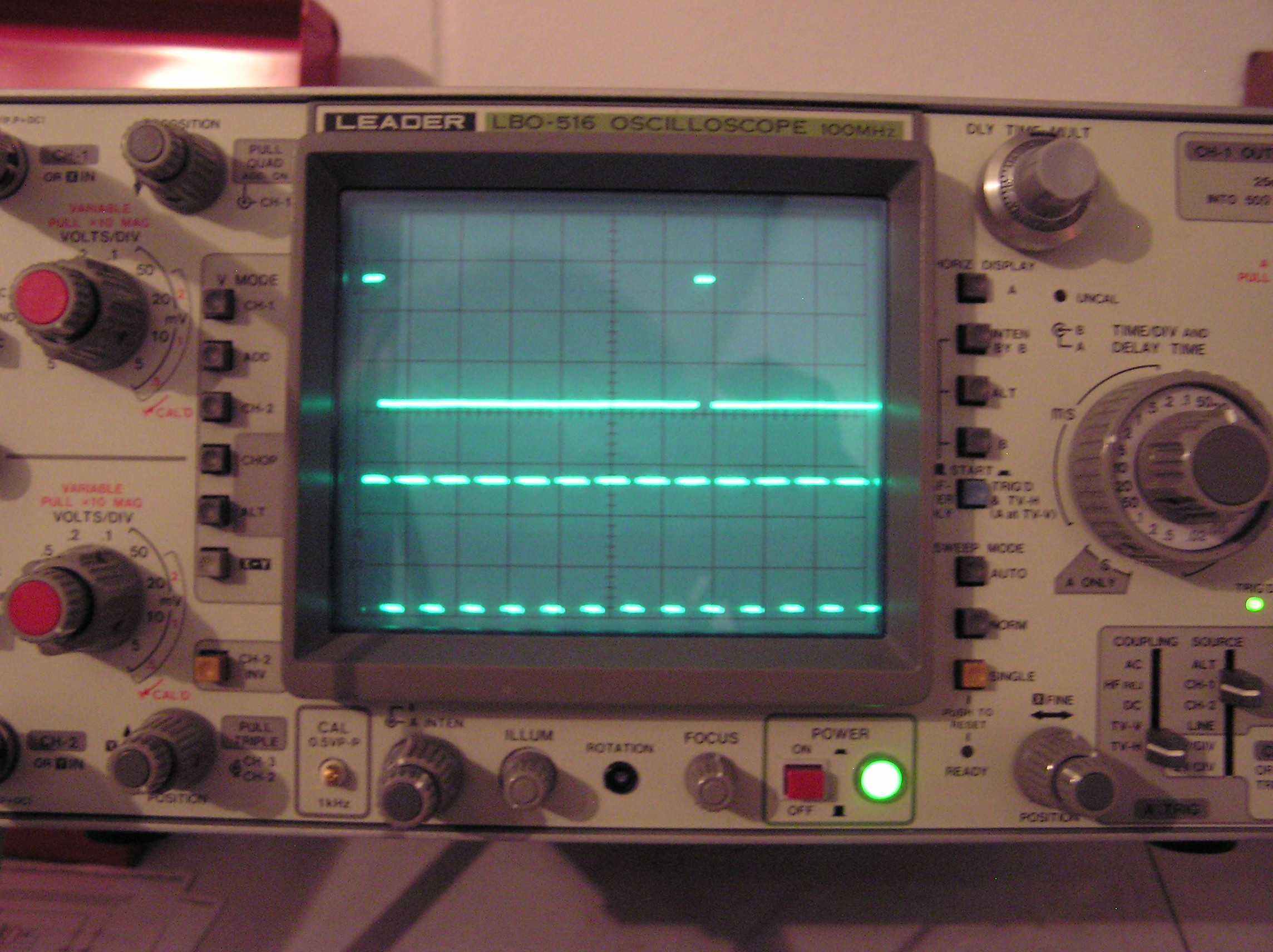

Electro Tech forum,
I'm doing the transmitting with a TSAL7600 High Power IR
diode. There's a carrier signal at 38KHZ and a modulation
at 32HZ. Each modulation pulse is 1.5ms in duration.
The receiver is a TSOP4838 which strips off the carrier
and outputs the modulation pulse.
I've attached a scope photo.
I can to send different modulation frequencies or
a different pulse width but then I need a way to
differentiate them. This is all cmos logic no
microcontroller although that's the final goal.
Thanks for the replies so far,
jerryd

If you are determined to work without a microcntroller, and your photo shows you already have it working with a fixed pulse train of 32 Hz then you can probably implement a freq encoded system.
If you modulate the carrier at 32 Hz (as per your example) you get 32 Hz output frequency from your detector. Then you could use a freq detector IC to detect that 32 Hz frequency and control a single output.
Obviously you could add a frequency detector IC for each frequency you need to detect. It's a little messy but if you only need to detect a few frequencies it should be workable without a micro.
On the other hand, if you can find a frequency detector IC that will detect and discriminate multiple different frequencies you are close to a 1-chip analogue solution.
(edit) Actually I was just posting in another thread about an engine tacho and it gave me an idea. Well actually it's an old idea.
If you get your output frequency (say 32 Hz to 100 Hz) to trigger a 555 monostable, filter the output with RC you get an output voltage proportional to frequency. Then put that voltage into a LM339 bargraph IC that detects different voltages and operates different output pins. That should be a working analogue solution.

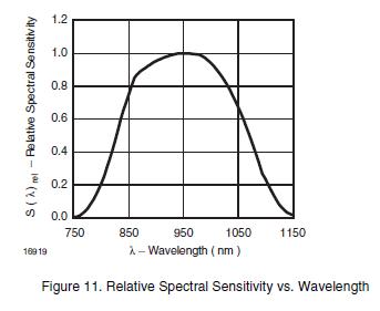

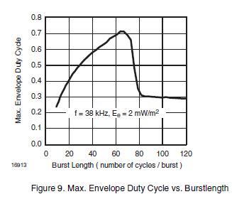

If you are using an off the shelf IR receiver, there are many things that make it work.
1. Directivity, of the lens. How wide of an area the receiver sees. This is like an antenna for a TV set. A 3 foot piece of wire is not the same as a 12 element directional antenna.
2. Frequency (color) of the light. You would never transmit in Green and try to receive in Red. A very strong Green light well be received just as two AM radio stations can interfere with each other.
3. Carrier In this case 32khz. Some 48khz signal will get into a 32khz system. 10 % off makes a big difference.
4. Burst The receiver is built to do best with data of 40 to 60 clocks long. You need to use this format. If you build a receiver you can do what you want.
