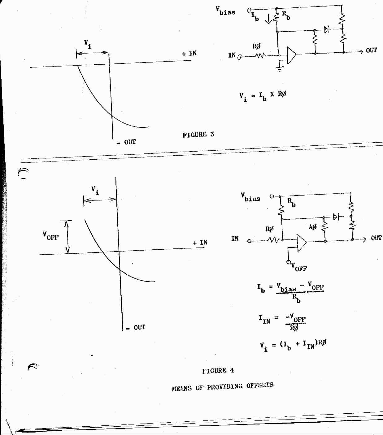

Many years ago I wrote a BASIC program to design a non-linear amplifier as below. I don't know if I can find it now, but if you are interested, I will look for it. As I recall, there is a program on my website that designs a non-linear network, not using an op amp. It works into a high Z load.
