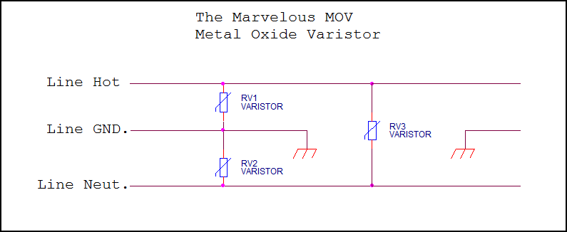

I'm a little confused because of them being likened to MOV's in series, if two devices with MOV protection on all three lines of a single phases system were connected to each other they'd be in parallel not series, I could understand the possibility of some strange oscilation issues right at the threshold of conduction but I'd like to know more about why these people are saying this is bad.
1. The OP's post is totally wierd. A UPS plugged into an SPD is not in series it is in Parallel. There are no issues.

Generally suppression is lots of stuff in parallel.
For example, gas discharge tubes can be used for a first shot, then MOV's for a second shot then an RF filter to get rid of the RF junk. These devices are internally in parallel and is effectively the same as plugging one SPD into another. It just increases the energy that can be absorbed.
Attached is a circuit depicting how the Marvelous MOV is generally used.
I agree with Sceadwian as to the terminology used as to "series". There is no series that I can see. MOVs are configured in a network as shown in the cartoon. If I plug one MOV device into another I have a parallel network of MOVs as I see it. Also when anyone begins to use the word "juice" in an electrical circuit I pretty much discount whatever follows. Here nor there.
While the MOV is a useful device I have seen the results of flames escaping MOVs on numerous occasions. They have their place in circuit protection but their use only extends so far. If I place a 150 volt MOV across my 120 volt line in theory when the voltage begins to exceed 150 volts the MOV will begin to conduct and subsequently a fuse or circuit breaker will trip. However should lightening strike the utility pole outside my house I wish me good luck with my MOV surge protection. A MOV just like a man has limitations and needs to know those limitations. :) This is also true of people employing MOVs as a protection device.
