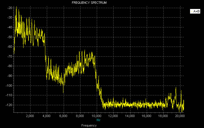

Thanks AG, I suppose I ought to set a loop of test tones on both channels to get a clearer picture of what is being lost in transcoding. Have to agree it does sound like mono, high frequency cut off is rather pronounced (practically nothing above 5730Hz) will take another look at the EQ settings.

have attached screenshot from the analysis software I have here, notches are clearly visible.
I don't see notches but I see and hear AM radio sound (100-4kHz)frequency response.

Over last hour we were using an external source of audio from the iMac fed directly into the mic input, software conflicts had rendered the normal 'line input' useless everything said it was connected , played through fine locally but the streaming software would not listen to it. As more logged on problems arose with available RAM and virtual memory so trying it again under a much lighter Linux operating system looks attractive. Most likely DSL or Puppy linux , results in the past have been good with these distros on older Pc's.
