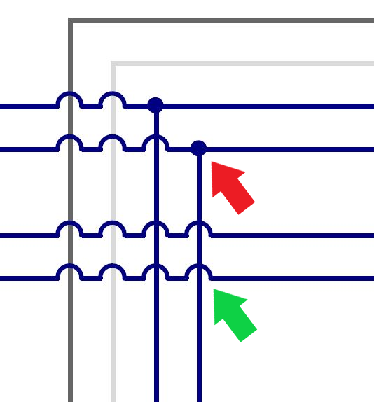

Hello, i need a help to identify a diagram attached ,
What is the RED arrow pointing to?
What is the GREEN arrow pointing to?
i will appreciate if anyone can help out. thanks

The dots mean the wires connect.
The "humps" mean there is no connection between the crossing wires.

...and the dot means the wires connect.
That is an old way to draw schematics. On modern diagrams "humps" aren't used and crossing wires aren't connected unless a dot is present.

When hand sketching a circuit I still draw in the humps, just so that there is no confusion in my own mind.*
