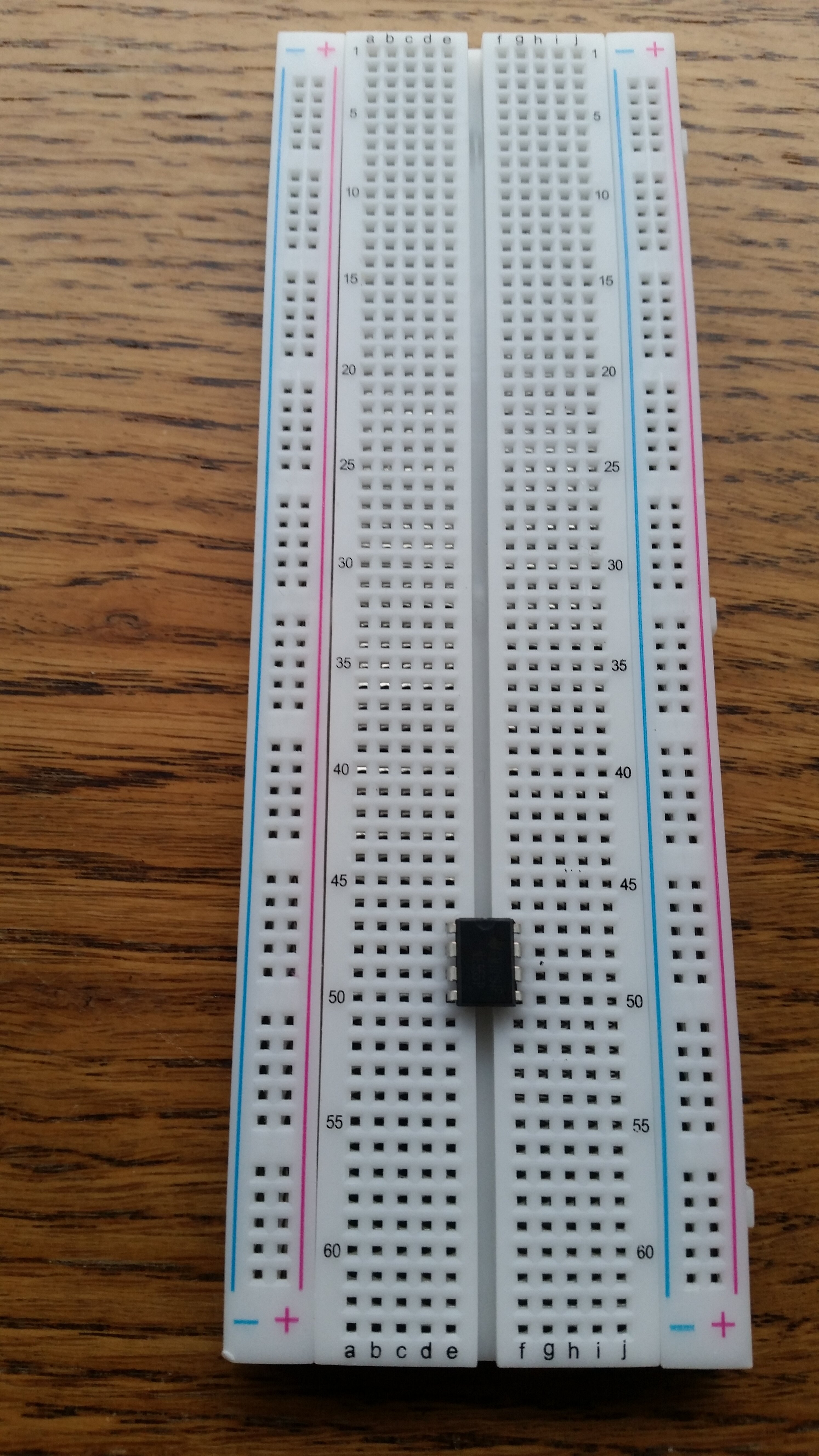

Diameter of breadboard holes incompatible with size of components pins and jumper wires etc.
MDC
This may be a common problem? An 8 pin IC for example fits perfect - very snugly as the pins on it are tapered. But is there a fix for the jumper wires and other components with straight pins, that are a loose fit in the holes? I am guessing the issue is with the boards.
AFAIK, the IC pins are not tapered. They seem to fit in snugly because the all the pins are not in perfect alignment with the holes. If you take the trouble to align them, they will just fall out if you turn the board upside down. Keeping this in mind, you can "snugly" fit in any component with 2 or more leads if you misalign them.
Sometimes, the leads are much smaller than the PCB holes. In such cases, I bend the protruding length sideways to keep the component in place.
That is a good idea, thank you.

This is the only board I have.
I only know it as a 'breadboard' , although it may have another name?
I have not heard of a Veroboard, but I will Google it now.
Thank you for the continued support, I appreciate and respect all the guidence.
As you said initially - that's a (modern) breadboard. I never use them, as they are so unreliable.
An original breadboard would cure your problem - because it was just a wooden breadboard (for slicing bread) with nails knocked in and the components soldered to them (and is where the name comes from). Veroboard is also known as strip board, and is a tradename - 'presumably' the original creator of it?.
Yes, a breadboard.
The individual sockets should grip wires quite well, and all my breadboards do grip well.
However there are some cheap/badly made breadboards which do not grip wires at all well.
I remember being in discussions with another member here who was having problems with a test circuit which would not behave reliably. The cause of all his grief was a cheap badly gripping breadboard.
At the risk of appearing harsh, cheap breadboards are just rubbish.
  • Like
Reactions: MDC
Each of the hole positions in a plug-in breadboard should have a spring-loaded socket underneath it, so it should grip wires or pins over a reasonable size range - but that is not unlimited; very thin wires may not connect, and forcing in a thick wire or pin will strain the socket contacts and make them unreliable on any smaller size wires.
The ideal size is around 0.5 - 0.7mm. Single strand wire from ethernet trunk cable or telephone wire should work OK, or purpose made jumpers with 0.7mm square pin ends ae ideal.
Breadboards do also just wear out with use and get unreliable in time, from fatigue and wear or corrosion of the spring contacts.
Because of that unreliability, the only time I've used them in the last 30 years or so is for youtube demo videos.
For any other kind of prototyping or experimentation etc., I use stripboard or square pad board and everything is soldered.
To differentiate, I call those, plug-in breadboards.
