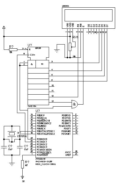

Did anyone try to run LCD using 2 wires?
Mindaugasu
The idea is to convert serial data coming to LCD using shift register 74HC164.
My routine tryout:

LIkely signals are OK by LCD giving me strange results few messy characters instead of one desired. I cant see where ismy mistake...

I think the E pin gets strobed too many times or too early. Even though you are ANDing the data pin with output 7 (pin 13), I don't see how it would work correctly. The E pin sees the sequence of each bit of the current output byte being shifted in ANDed with each bit of the previous output byte as it is getting shifted out.
I would use a 74HC595 which has output registers that you load via a seperate strobe line. 3 pins vs 2 but complete control of the output.
Alternatively, you could move the input to the AND gate from PC0 to some other pin on the uC (PC2?). Keep it 0 until AFTER the E bit is shifted into place and then toggle it.
Like Philba has said, you cannot allow the LCD "E" line to pulse while you are setting up the data as strobing the "E" line would cause the LCD to accept whatever data currently on the data pins.

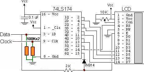

I would refer you to the follow webpage:
Build your own "2-Wire LCD Interface"
and use a 74HC174 instead of the 74HC164. I tried it and it works.
hmmm, that's a cute circuit and code. the original circuit should work if he first outputs a 0 byte and then the actual byte to be output. The zeros being shifted in keep E low and then the zeros in the SR keep E low until the actual E bit (high) is shifted into place. since E is at the end of the SR, the data output pin needs to be set high after tha data byte has been shifted in. I'd switch it around so that the E bit is the last to be shifted in and thus it just works. I'd also just use the 1st 6 outputs of the SR so you only have to shift 6 bits, not 8. (ok, 12, not 16).

If you shift the "E" bit in last, can you explain how the LCD "E" line is kept always low while the data is being shifted into the latch?
I am familiar wit this example. Using my schematic e signal shouldn't be strobed multiple times because there is AND element standing. I shift nibbles to register in format [ddddxxRE]
dddd - nibble;
x- not used;
R- RS;
E- enable;
I send this byte in 8 clock cycles in last cycle I get 74hc164 Q7 bit high and then I toggle controllers data-line to "1" and both with Q7 line they enable LCD E signal through AND element. After this nibble is saved, then I set microcontrollers data line to "0" (this gives "0" in AND element) and then clock register 8 times to clean it. In my opinion this schema should work. In my personal opinion there is somewhere mistake in program not in shematic...
I understand with 3 wires it would be much easier, but I want to make this with 2.
Anyway thank you guys for response.
You're right. The hardware should work. The AND gate would held the LCD E line low when you shift in the data.
At last it is working. Changed a little bit schematic - I used diode and resitor insted as AND gate. And also changed the code. I found a bug where data were shifed to register.
