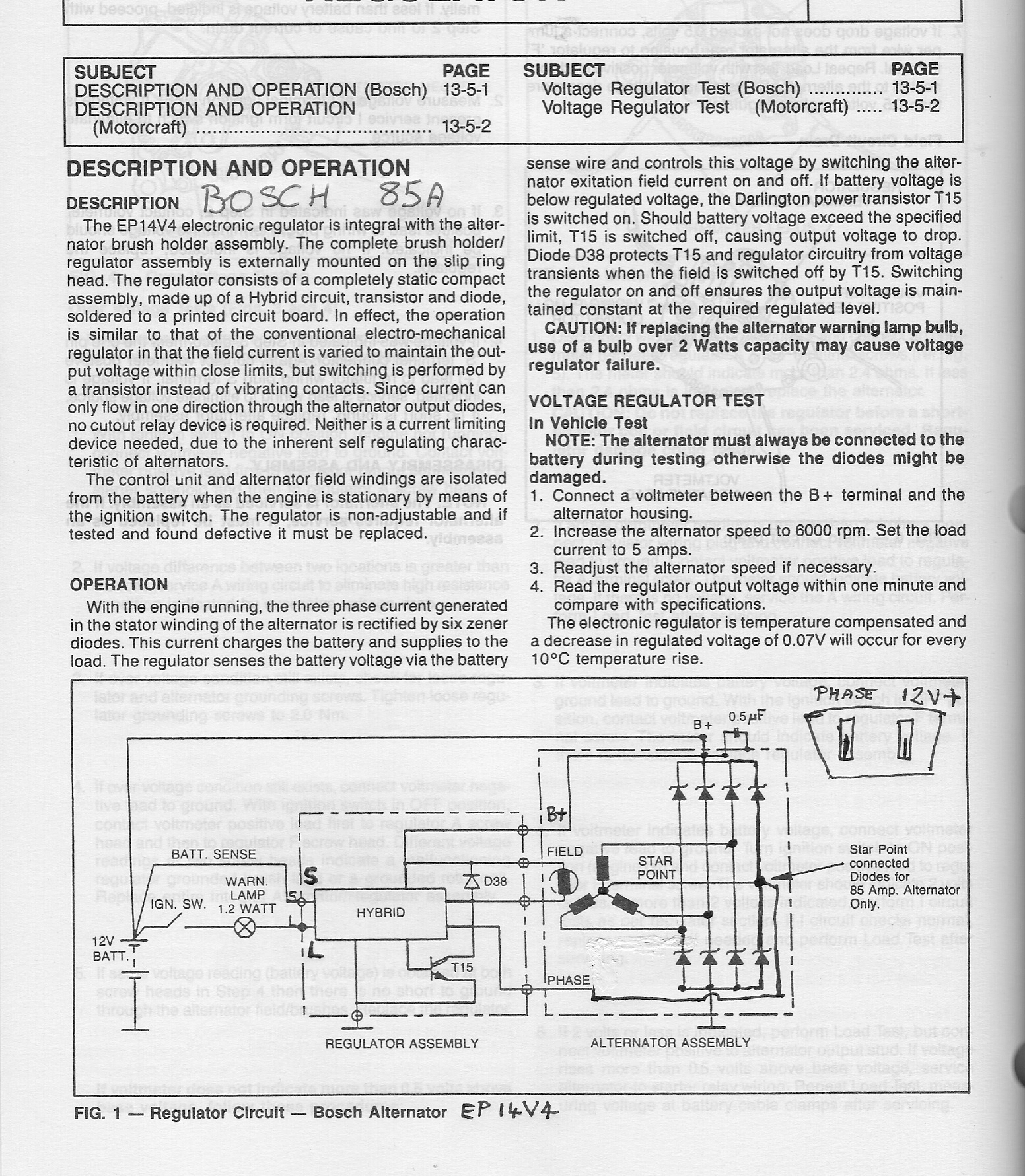

According to a discussion in the link below, fitting the wrong globe can indeed fry the alternator, as the globe current draw is what excites the alternator. Too many watts, the regulator craps out. The recommended 2W for the alternator in question on that thread. I don't know what alternator you have, but your 5W globe is over double what they were discussing.
Keep in mind they are talking about a specific car with a specific alternator with a specific circuit. Not all car/alternator/circuit configurations use the globe to excite the alternator. Not knowing what car you have or what's under the hood, I cannot speculate as to whether you did or did not damage the alternator, but I can say that it is entirely possible.

Not all altenators will handle the wrong wattage globe. Some as in this Bosch altenator, the reg can be damag
ed by wrong globe.

Those pages I posted Strantor come from the Ford Workshop manual & relate to the Altenator in the V8 link you posted
Thank you Daryl. I appreciate you backing up my suggestion with a textbook reference after b.james sought once again to adulterate a contribution of perfectly valid content with doubt and contempt.
