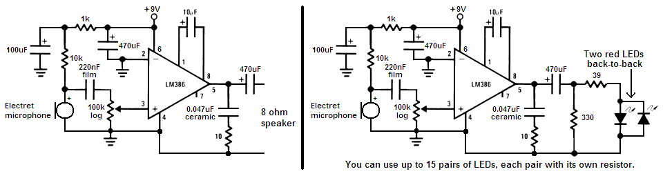

The LM386 can drive a speaker or it can drive up to 15 pairs of red LEDs like this:

A "condenser" microphone needs a 48V supply voltage. I think you probably have an electret condenser microphone that has the 48V built-into its electret material. It has a Fet transistor inside that needs about 0.5mA through a 10k resistor from about 9V.
I showed you exactly how to hook up an LM386 to an electret mic and to a speaker or to many LEDs.
