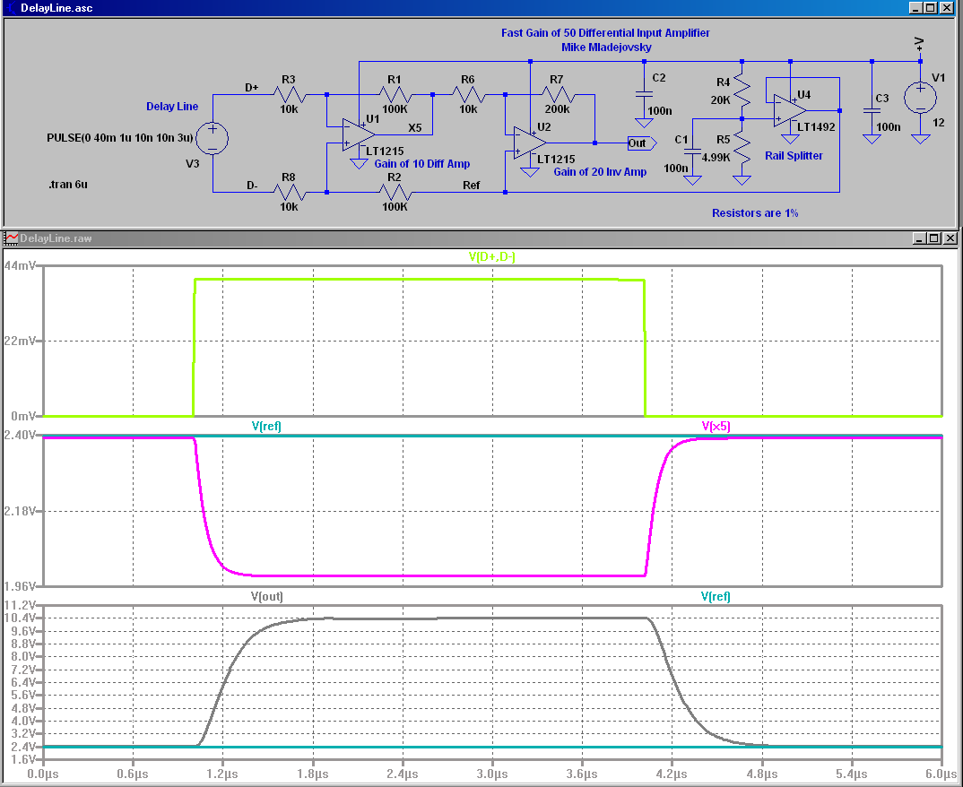

Attached is a simulation. I first tried an LTC Instrumentation amplifier, and it was way too slow. I built a Gain of 50 differential amp using a high-speed LTC opamp. It worked, but it was too slow, too. I then split it into a Gain of 10 Diff amp, followed by a gain of 20 inverting stage, and it works well. I made it so that it operates off a single supply. The rail-splitter (pun intended) is offset to allow for the asymmetric pulse. The floating voltage source at the input simulates what will come out of the delay line, a 3usec wide pulse.
The LT1215 is advertised as a "high-speed" opamp by Linear Technology. I used it in the simulation because LTSpice includes models for all of their products. I tried some slower ones, and they add a lot of delay, and their slew-rate is inadequate. These are pricey, but you will have to use an equally fast opamp if you are going to buy it from someone else.
I suggest you simulate the whole circuit, including the integrator. I have attached the ASC file so you can play with it...
btw- the title says gain of 50, but it is actually a gain of 200.

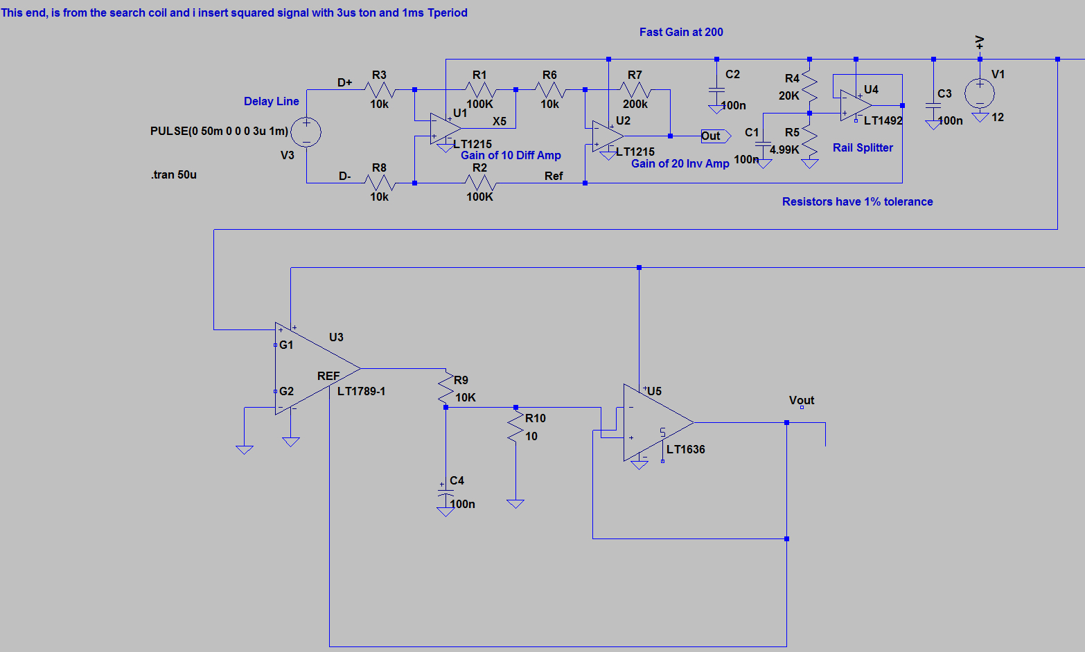

I used the circuit you attached and put 50mV input signal and ton=3μs and Tperiod = 1ms. I designed the integrator and attached it on this circuit and it works just fine and quick (i think). Can you take a look at it?

hi pm.
Just in case Mike is busy, I would suggest you recheck your Integrator circuit.:)
I will leave it to Mike to talk you thru it.:)
hi pm.
Yes, Eric is right. What you show is a poor low-pass filter, not an integrator.
I don't have time to post more right now. Do some reading and Googling for "opamp integrator" in the meantime.

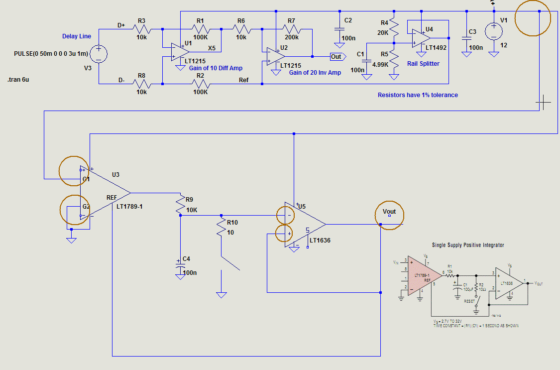

hi pm,
The ringed areas in the attached drawing need reworking.
I see that you are looking at the Integrator circuit from the datasheet, located bottom right.
I corrected some circled areas. I do not understand what's wrong about Vout - area.
From which spot should i take the signal after the 200 gain circuit and lead it to the next circuit (amplifier + integrator)?
P.S. You are right. I used the integrator from that datasheet! Sorry about some questions. I just started playing with this stuff and i do not know much
Consider which signal you wish to integrate, the dwg at moment shows the input for the integrator is connected to the positive power rail.!
Why would you want to integrate the power supply voltage.:)
Look at the dwg that Mike has posted, find the point marked Out, this is the signal of interest.

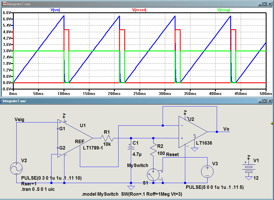

Look at this LTsim of the Integrator section.

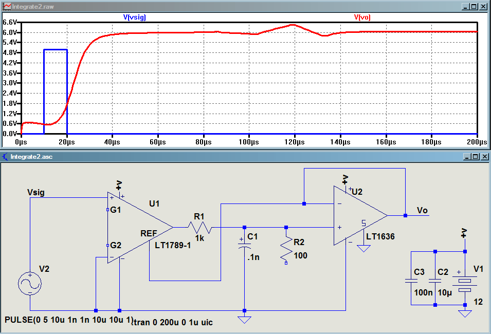

hi pm,
The integrator is too slow.
Look at this image.
  • Integrate2(2).asc

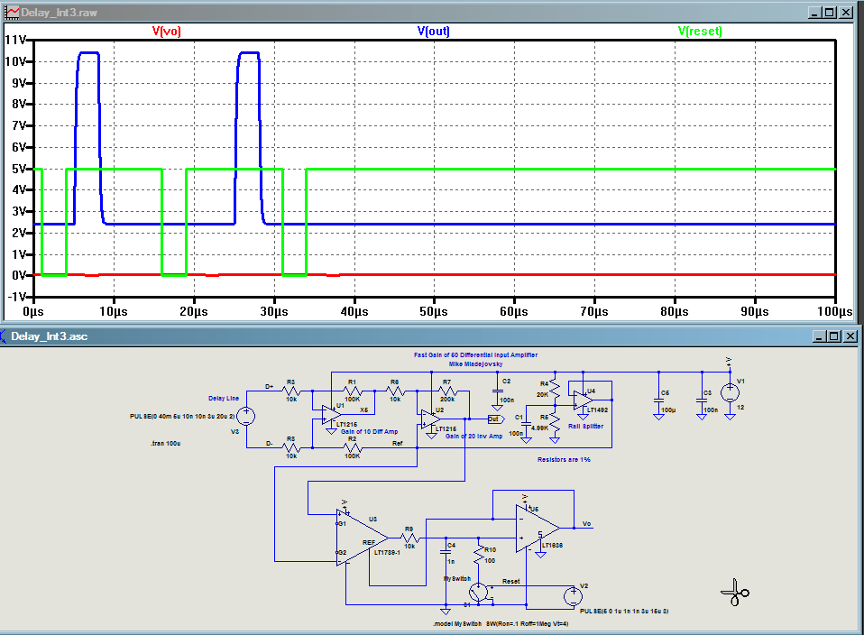

You are right. I fixed the circuit correctly and it is slow...
Do you suggest any other faster way to stabilize my signal at Vpeak?
Do you mean you want a peak detector and not an integrator.???
What is the output of the detector connected into.?
EDIT:
Mike's amp work just fine, but the integrator cannot follow.
  • Delay_Int3.asc
