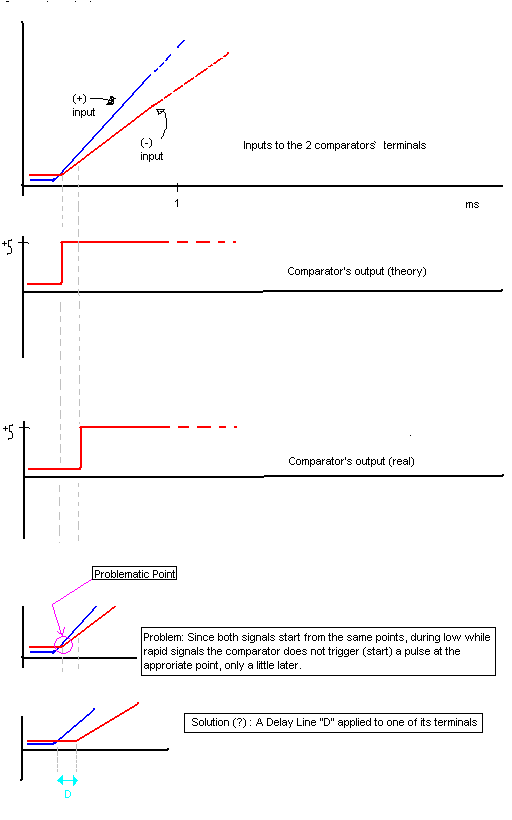

I have this project where I am testing the behavior of comparators when they are fed with two (continously changing) inputs into is terminals,
instead of having a signal in one input and a "voltage reference" to the other.
See schematic below.
The main reason for this post is that it seems I have encountered a problem which I found suprising:
Since the signals fed into the comparators' inputs are starting at the same point, during low voltage/fast signals the comparator is not being able to cope with that and does not trigger (start) a pulse from the point it should; but from a point a little later.
Can anyone please advise me on the nature/causes of the problem?
I have been asking some firends and they said that this could be solved by a delay line into the "red" input" (?)
Yet, I am a little concerned about the fact that a delay line could cause a considerable amount of addition of noise.
So, is there someone of you who who can think of a "noiseless" delay circuit?
or perhaps another solution to my problem?

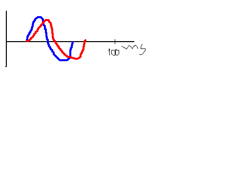

Nothing fancy as a schematic, just a function generator in the lab feeding a LM393.
The signals going into LM393 are of a same voltage, but the red is twice as "slow" as the blue one.
I did this experiment to see how a comparator works when it has to analyse a differential input signal.
The signals vary from 60mVs to 6 Volts, I have experienced the "problem" below 200mVs or so.

The first plot you posted doesnt look like a problem at all. Your "comparator theory" plot shows the comparator switching in zero time when its two inputs are equal (+) & (-).
In reality, the comparator needs to first see a certain amount of difference (the amount is determined by its gain) and then it will drive internal circuits to trigger the output. This obviously happens at a later time. The ouput happens at a later time not from the time the inputs were equal, but from the time the inputs differed by a sufficient amount such that the comparator could "see" the difference. A comparator output state is undefined when the two inputs are identical. Noise will push it on eway or the other but probably not for long. This is why hysteresis is added to the circuit.
So your second plot of "reality" is doing just what I described.. so whats the problem? The comparator works as advertised. You read the datasheet right?
I think you dont have a problem at all _OR_ I am really really way off in understanding what you are talking about. But I agree with RON, the notion of needing a delay line seems absurd. You may be trying to fix a perceived problem that really isnt a problem. Maybe what you need is a faster comparator. If microsecond delays offends you, you can get comparators with sub 10 nanosecond delays.

The LM393 (and all true differential comparators) responds to the differential input signal. If you want to see what the comparator is driven by, subtract the inverting input from the noninverting input. The switch point will be where the diff. input crosses zero, with some (possibly a lot of) propagation delay. This wiil be true until you get to a relatively high frequency, where common mode rejection starts to degrade. The problem is, the comparator response is not specified for slowly slewing signals, so it is difficult to predict what the response will be. The comparator has a lot of gain, but very low bandwidth. With very little overdrive, the delay will be long because of the low bandwidth.
The response time is only specified for a fast risetime, 100mv step with 5mv, 20mv, and 100mv overdrive. See p. 6 in the **broken link removed**.
