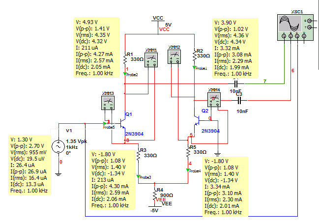

Hello,currently i'm designing single ended to differential signal converter.I use differential pair with emitter resistor.In order to get the Q-point,i have to know about my Vce cutoff point.But, the problem is i'm not sure what is my Vce cutoff point.Below is my attachment about my circuit~

hi penny,
How did you get those values in the yellow text boxes.??

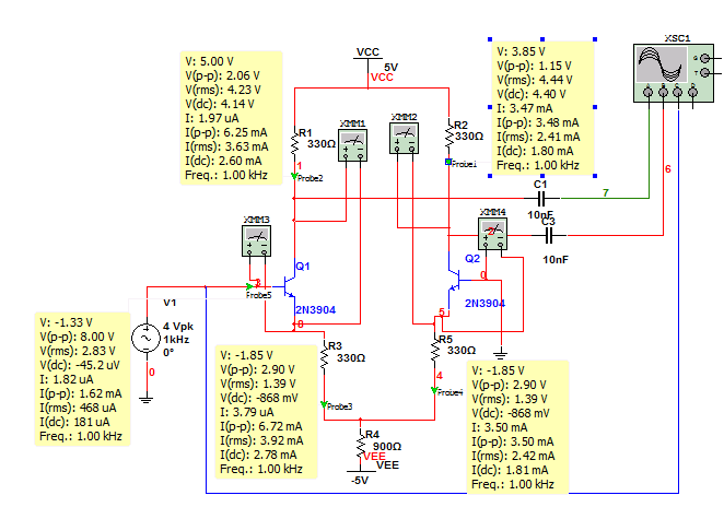

With a 8Vppk sine wave input the collector signals are grossly distorted and those values are meaningless.
Try a 1Vppk signal , also consider a constant current source for emitter drive

i use measurement probe to get those yellow boxes.How to know that the maximum of the input signal can be applied to avoid the distortion to occur?because the assignment requests us to find out the reason behind~and what do you mean a constant current source emitter drive?

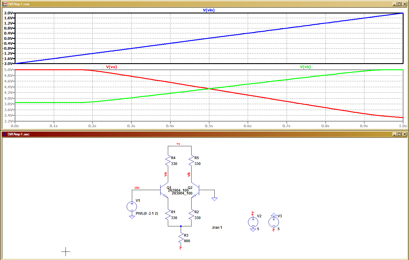

hi penny,
This simulation of your circuit was done using LTSpice.
I have used a ramp input signal, you should be able to confirm your distort level input from the plots.
E

the image which you posted, the Vic is Vppk or amplitude?
For a Vin signal I used a DC source which increases in value from -2Vdc to +2Vdc.
The Va and Vb plots show the DC value of both collectors for all values of the DC Vin sweep.
As you can see the Va and Vb plots follow in a linear way the Vin until they start to saturate , either high or low.
At the point where the Va and Vb are unable to follow the changes of Vin, thats where the saturation starts...
E
EDIT:
So look at Vin level when Va and Vb cannot follow Vin, thats the 'distortion' Vin level.

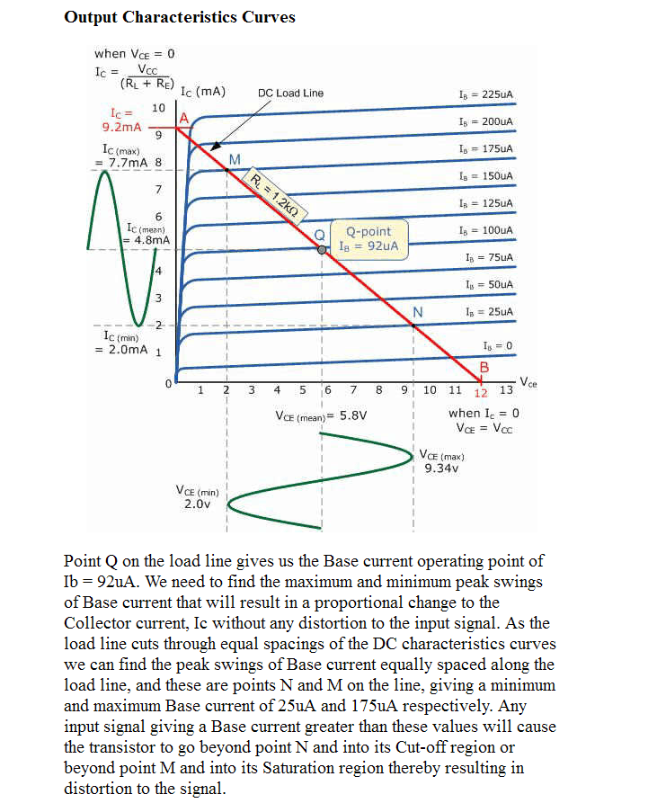

in order to get the maximum swing,normally the Q-point of the circuit will be on the center of the DC load line,but the problem is i don't know how to calculate my Vce cutoff point,thus i cant determine where is my center of the DC load line.
Now,i'm not sure that the circuit i designed,its Q-point is on the center on DC load line or not.

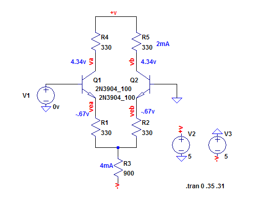

This image shows your circuit with a 0V input signal. [as its 0V, its connected directly to 0V.
The DC levels I have attached should enable you to fix the DC operating point.
E
E
i'm still a bit blur~so 4.34+0.67=5V is my Q-point or my Vce cutoff point?
Does this image help you to fix the Q point on the load line.? I have given you the steady state DC operating voltages,
