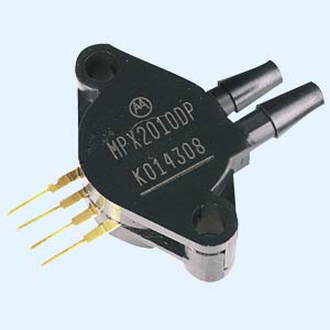

You'd be better off using an MPX5500DP. Maxim pressure 500KPa. "DP" stands for dual port, meaning it is fitted with two plastic pressure ports to connect hoses to them.
To measure the actual water pressure it requires to sense the water pressure on the positive pressure port and atmoshperic pressure on the negative pressure port, resulting in true water height regardless of loacal air pressure variations, which might fall to 850HPa in a low weather system and rise to 1,100HPa in a high.

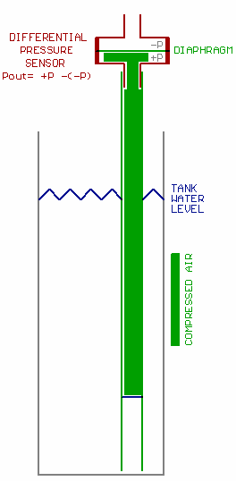

For better understanding I attached a small drawing showing water level detection. It works the same way detecting water pump pressure.
Pic2 shows a dual port differential pressure sensor.
Boncuk

If you connect a hose to the pump outlet the air in it will be compressed with increasing water pressure. The principle remains unchanged. All you measure is air pressure, no matter if it's caused by a water column or a pump.
Nothing to seal watertight if you connect the hose to the positive pressure port of the sensor and the other end to the pump outlet leaving the negative pressure port open to the atmosphere.
