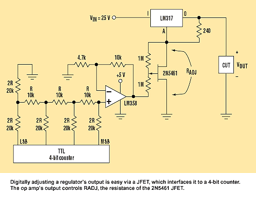

This comes from EDN magazine, online edition. Could not find the note accompanying this.
I think you can implement and test it with no further help.
PLease note that depending of the number of steps required you could need to extend the R2R network using more bits.
Last note: keep in mind that you can play with Rf and Rin of the op amp too.

1 - The Rds of 2N5461 is temperature dependent so the output voltage will be temperature dependent

If this is a school project I think the idea is to use the precision and the temperature stability of LM317 to build a digital controlled voltage source , both ideas have the same lack , if you multiply (first case) or add (the second case) an imprecise value to a precise value you will have an imprecise value at the end. Sorry for the criticism , I'm still searching for an working solution.

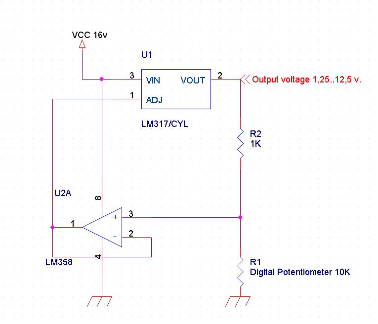

Improved version of digital pot solution, the Iadj will go through the op amp repeater output , not through R1 R2 divider
You will need a calibration procedure because the digital pot have a tolerace of 20%.

In your last diagram where to connect the PIC?
