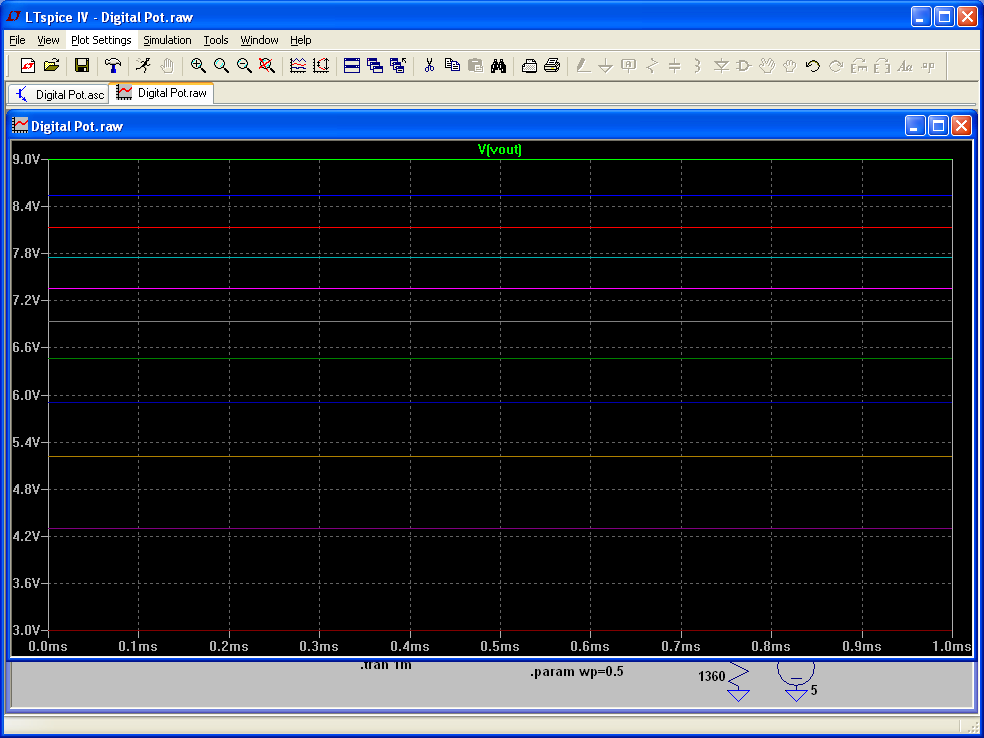

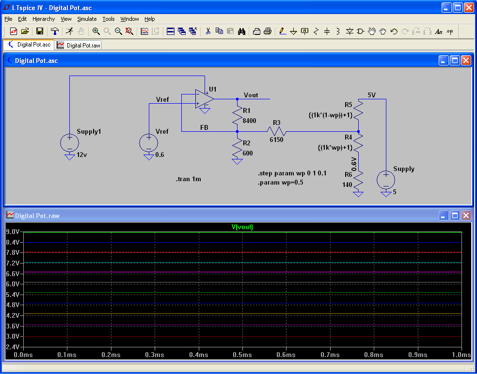

Using what Diver300 said:
U1 is the power supply.
R5, R4 is the digital pot. I have it changing from (R5=10k to 10 ohms and R4=10 ohms to 10k) Spice will not allow 0 ohm resistors.
R1,R2 is set for 9V.
The bottom of the pot is jacked up by 0.6V. This way then the pot is set to the bottom end there is 0.6V on each end of R3 so R3 has no current and does not exist.
The output is not linear but...
Pot set to step from 0 to 20% to 40%.....100%

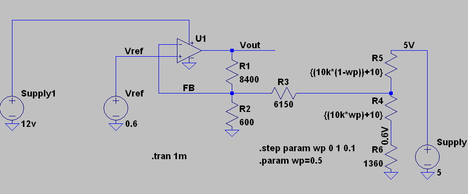

Thank you for that, Ron.
I assume that the lines are every 10% from 0% to 100% as there are 11 of them.
I think that the output would be more linear if R1, R2 and R3 were large compared to the potentiometer resistance. Can you run the simulation with those three resistors 10 time the existing values?
Cut the POT to (1k to 1ohm).
---edited---
Thin I tried increasing the other resistors by 10X and it is even more linear.

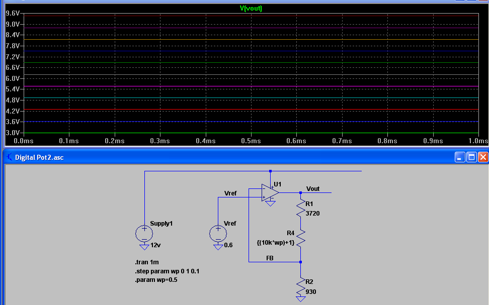

This is my first try, which I delete.
R4 is the pot, using 2 pins not 3 pins!
Problem is that the top of the pot gets to 6.5 volts!
The output voltage goes to 9.46 volts so don't use the last couple of steps, to limit to 9.0V.
R1,R2 sets the 3.0V. R1,R4,R2 sets the 9 volts.
