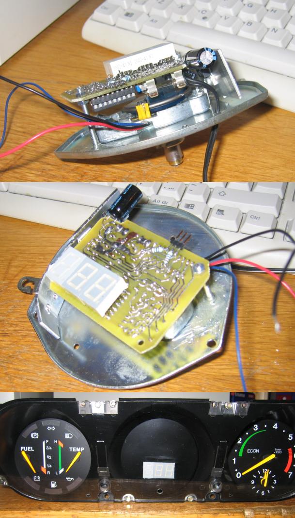

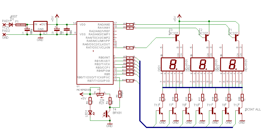

I did exactly this about six months ago. I wanted it to be SIMPLE. I used a 16F628, you could mod it to work with 16F84, but it doesn't have the timer1 module I used. I used interrupts to update the multiplexed 7-seg displays and Timer1 to count pulses.
Then what I did was take a GPS receiver and drove 100km/h according to it and adjusted the counting delay so that it would show the correct value. I ended up with a 1.5 sek delay, but that doesn't disturb me. I'm patient enough to wait 1.5 seks for the next update.
My meeters pointer got stuck so that it didn't move anywhere, but otherwise it was ok. So I removed the whole "display" part of my meter and left the spinning magnet where it was (Old meters have a spinning magnet inside them, that moves the pointer when it is turned). Next I put a magnetic sensor fom an old dc fan next to it, and voila I had my signal source. It gives 4 pulses per revolution.
You'll notice that the shematic isn't exactly what's on the PCB board because I did some fine tuning after I already had made the board.
I attached some pictures and the software below. Yes I know it isn't the best way to do it, but I built myself a very accurate speedometer that works, that's all I need.
Maybe this will give you some ideas.
