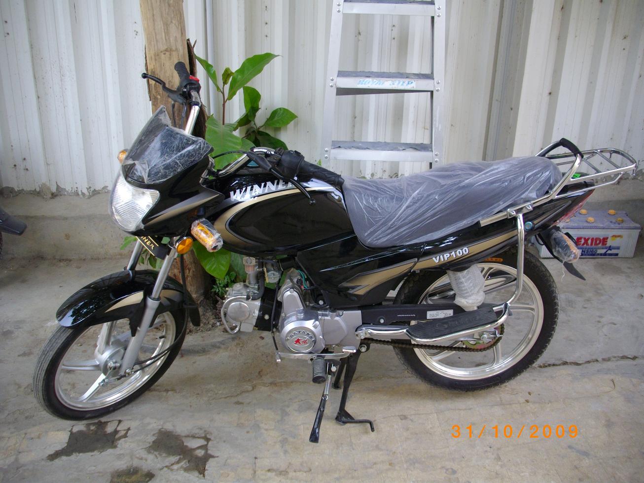

Dear All i want to make digital speedometer for my motrocycle Dayang 110-26 i want to know about the speed sensor .. which sensor i should use for speed sensing .. so that i read signal .....

its my hobby too .. but m going to use this in my motorcycle ...
now plz can you tell me where should i install IR transmitter Receiver on my front tyre ?

I would advise against the optical sensor
as the sensor will get dirt in it thus causing false readings.
As I understand it most use a hall effect sensor.
this uses a magnet attached to the wheel or other rotating object.
determine circumference of wheel number of rotations for say 10 feet
then calculate the time.
there are electronic speedometers on Ebay as to build an accurate unit a micro-controller is suggested.

Thank you soo muchhh... i should consider this option ....

can you tell me which hall effect sensor IC (Digital output) should i use?
depends on how far you want to go
just google bike computer or bike speedometer.
then hall effect switches.
here is a couple of links
the bike computer I think uses optical sensors but a hall effect sensor could be incorporated very easy.
the second link diecribes a hall effect switch arrangement.
reed switches could be used but are not as reliable or IMO as fast as a hall effect sensoe.
look at automotive ingition systems - they mostly use a hall effect type sensor.
good luck
