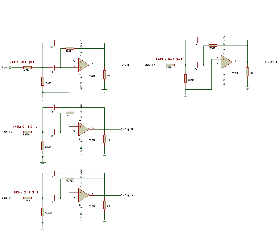

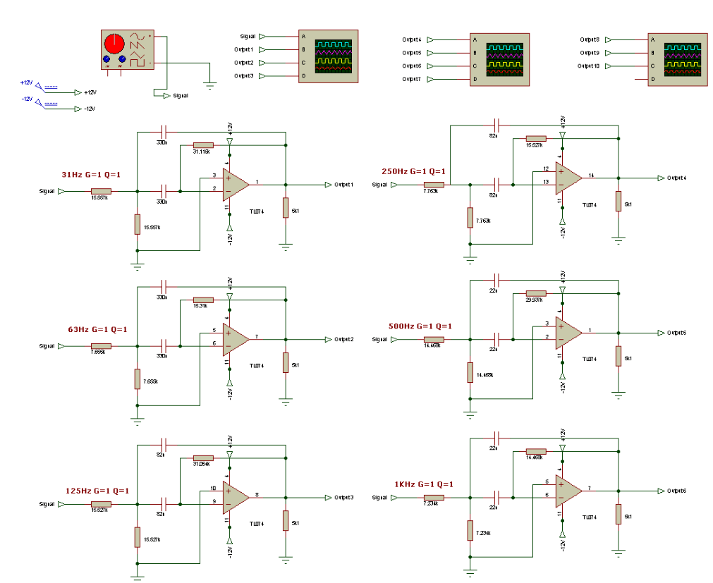

I've managed to find some data on the bandpass filters, and constructed a simulation for a 10 Band vu meter (Just the analogue aspect so far).
  • The bandpass filters are tuned for 31, 63, 125, 250, 500, 1K, 2K, 4K, 16K
  • The Q for each filter is 1 (I'm really not sure if this is an optimal value, but 4 is used for very steep cutoffs, 1 seems to do the job so far...
  • The gain is left at 1 for the amps, as I figure that volume (sensitivity) can be controlled by a pot on the input
I thought I'd show you what I meant before I hit the hay;
Image 1
Image 2
Video
of the simulation - I run through every tuned frequency (16KHz to 31Hz) and have all 10 channels displayed on oscilloscopes to view the amplitude variations at different frequencies... Its un-edited, sorry if there are mistakes!

A 18F should be more than enough... maybe even a 16F depending the speed, accuracy, filter algorithm & preamp you use.
EDIT: what happen if you just sit a RC filter at the ADC input and do some basic ADC averaging, then dump the results to your LEDs? Shouldn't be as this hard.
