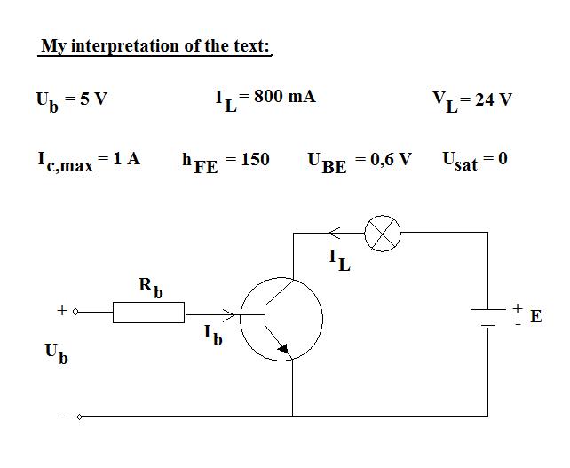

Hi there!
Would be grateful for help regarding the following problem. :)
Translated from my textbook the problem sounds:
Quote-------------------
"By means of a photosensor and a comparator 5V is given when darkness,
and 0V when daylight. The signal generated is maximum 10mA. A lamp, which
consumes 800mA at 24V shall light when it is dark. To accomplish this, a
transistor swith is used. Your task is to calculate and dimension the
resistance, and draw the corresponding circuit.
The transistor withstands a current of maximum 1A, .i.e. Ic,max = 1A, and has hFE = 150 times (i.e. the beta-value).
Also U(BE) ~ 0,6V and U(sat) ~ 0V.
The circuit does not have to include the photocell and the comparator,
instead only the darkness/light signal is assumed." -----------end quote
I have attached a picture-file where my idea of how the circuit should look like, is shown. The answer to this problem according to the book is:
440 < Rb < 810 Ohm
Would be very thankful for some help here. ..... :eek:
Thanks!

hi,:)
Assuming that the transistor saturates at 800mA/150hfe, the base current would be 5.3mA to cause saturation.
If Vsignal is 5V and Vbe is 0.6 then for Ib= 5.3mA thats [5-0.6]/0.0053 = 830R
If the Vsignal can only supply 10mA then Rb = 4.4/0.01 = 440R.
Does that help.?
EDIT: I would use a 470R base resistor.
The book and Eric are wrong.
hFE is used when a transistor has plenty of collector to emitter voltage like an amplifier. All datasheets for transistors show the max saturation voltage when the base current is much, much more than the hFE would make it.
For this transistor to saturate then the base resistor should have 80mA and be 55 ohms.
A 2N3904 little transistor has a typical hFE of 230 but its max saturation voltage is shown when its base current is 1/10th the collector current.
EDIT:
The source can supply only 10mA so the transistor will not saturate, the load will have reduced voltage and current and the transistor might burn up.
The load is an incandescent light bulb? Then it draws up to 8A when it is cold. It won't light with this transistor with not enough base current.
I suspect the author of the text book is talking about a theoretical transistor, not a 2N3904.
I am aware of the decrease in hFE versus hfe.
The book also gave a Vsat 0f 0V, which I am sure you know is also theoretical for a transistor.
I would say to the OP that the calculations I gave are within the parameters supplied in the book.:)
Thanks Eric!
Just as Eric is writing the author is assuming a theoretical transistor. Also his answers are the right ones. Thanks Eric!
