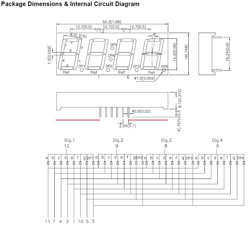

Please see attached. This is from part number CC56-12SRWA (Kingbright 4 Digit 7 Segment display)....
Where are DP5 and DP6 connected??? Also, as indicated by the two red lines, in order to make a PCB package for the part, I can't seem to figure out the distance that the pins are from the edge of the part, length wise...
Am I being stupid and over looking this, or is it actually not specified in the datasheet?!?!
Thanks as always!

Hmm ok, different model for Clock style DP points is required - so that part is sorted... Still can't find the bloody dimentions though! lol

The dimensions are all on the pdf,, in millimetres.?
As you say the DP5/6 are the 'colon' on a real time clock version, usually flashing at 1 HZ
EDIT: added gif
Is this what you mean?

Exactly what I mean... Thanks, it's definately a interesting way to figure it out and I did overlook that part :)
DP5 and 6 aren't connected on the specific model I posted, they are connected in models like the CC56-21SRWA. -21xxx basicall is the clock displays where DP5 and DP6 is connected (DP1 to 4 NC) and the others have DP1 to 4 connected and DP5 & 6 NC...
And yes, it might help if I look for dimensions instead of dimentions LOL - obviously I lacked (and still lack) some sleep or something.
